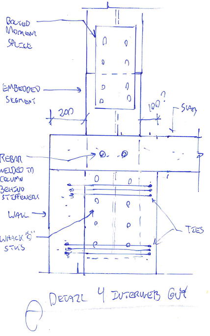

Working on a 4 story moment framed building and having issues with drift for wind. Building is 61'-4" tall (15'-4" floor to floor) not counting the mansard roof. I have worked on taller buildings but they ended up with braced frames or concrete shear walls. Building is L shaped with dimensions approximately 270 ft x 230 ft for the outside bend. The long side on the outside of the corner has a 5 degree slope in plan so all of my moment frames on the outside of the building are 5 degrees from orthogonal. After lots of reading, I decided to use H/400 for the building. Building is located in a 120 mph wind speed and SDC B. Using a 25 year return for the wind (factor of 0.49 for checking drift), I cannot seem to get the drift at the second floor to meet H/400 or even H/300. I am limited to W14 columns and they are getting large (W14x132 and larger) and increasing the weight has a small affect on the drift.
Having not done moment frames this tall I am working to eliminate the doubler plates (web panel reinf). Also, looking at using bolted flange plates instead of direct welding beam flanges to column. Anything else that is a major concern cost or design wise?
Thoughts for stiffening the building:
Use W18's for the columns. This will be a hard sell to the architect.
Fix the bottom of the columns to the footings. Not something I normally like to do.
Are there any other insightful ways to stiffen the building that I am missing?

I came up with the 0.49 factor by taking a 25 year return, using the nominal wind speed in the commentary, changing it to ultimate, ratio it with my design wind speed, squaring it and then multiplying it by 0.6 for actual. The V nom is 84 mph which is 108.4 mph ultimate so my factor is 0.6*((84/0.775)/120)^2 = 0.49. Lots of brick and a fair amount of curtainwall is on the building. The problem with fixing the base plates is there are a lot of piers due to a partial basement under the 220 ft leg. All of the columns on the exterior wall at the basement are on piers and I cannot get the room to fix the base plates in the direction perpendicular to the wall. My column is 16" in from face of brick and 8" from edge of slab/face of stud. I had to bump out the pier 1 1/2" just to get the W14 base plate to fit on it with any sort of construction tolerance. I can fix some of the base plates so I may look at that. Using the 0.42 (10 year) reduced the drift at the 2nd floor to H/329 which seems more reasonable. I meet the H/400 at the penthouse level.
You gotta work a little harder for it but there are ways. I've shown one below. Now that I think of it, erection might be easier if the embedded steel column extended to the footing.
