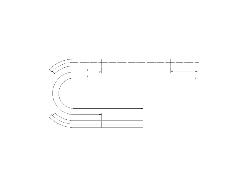

Hello
I have an inquiry about the drawing of automotive cable i didn't know how does it made if any one have an idea or video explaining this drawing will be thankful
RE: How to drow this ?
I don't think you can do this with SolidWorks right out of the box. Maybe you can hack your way into doing something similar but I don't think it would be worth the hassle.
If you can have both ends in opposite direction then it would be easy.
Patrick
I do these every day. Make the assy straight, then add a bend in the cable in another configuration. Section cut where needed in a drawing.
