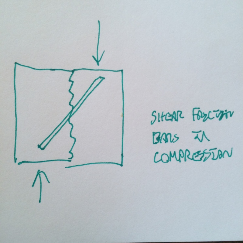

RE: Direct Shear ACI code 318-11
1) for members in net tension the rebar at demand is addituve. You need tension rebar plus shear friction rebar.
2) for compression members, permanent compression loads can be deducted from the amount of tension reinforcement required for shear friction. You cannot double dip with compression bars however. If the compression that resides in the bars has already been counted as part of the permanent compression, it can't also be counted as shear friction rebar.
3) For flexural members, tension reinforcement can generally be deducted from the amount of tension reinforcement required for shear friction.
Lastly, you can't use inclined bars for shear friction if the shear load would put the bars in compression. That's just because that condition hasn't been tested.
Your last Statement
Component of the inclined link will act in shear friction and other component will not(your statement is not clear,please clarify it in simple example)
