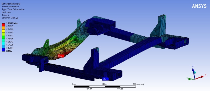

Hello guys,
I want to calculate the safety factor on container support design of gear box and I need your tips
The actual mass = 1600 kg
I assumed the mass to be = 2500 kg
= 2500 X 9.8 = 24500 N
The material is Steel A36 (Structure Steel)
So, I choose static structure, performed the mesh and remote force (24500 N) to be applied in the center.
and the result is:
Total Deformation
Equivalent Stress
and the F.O.S equation will be:
F.O.S = max. strength / Design load
= 2500 (kg) / 668.73 (MPa)
= 3.73 > 1
I'm hope my calculation is right
Please if you have any tips or comment, share it with us
Thank you so much for your time

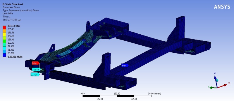

I checked for the analysis again
The assumed weight I think is much higher (2500 kg)
In the Technical Manuel the gear box weight is 1117 kg
So I will assumed 1400 kg (The whole weight of the container + Support + Gear Box = 1400 kg per to TM)
So, The results are:
Factor of Safety = 250/231.11 = 1.08

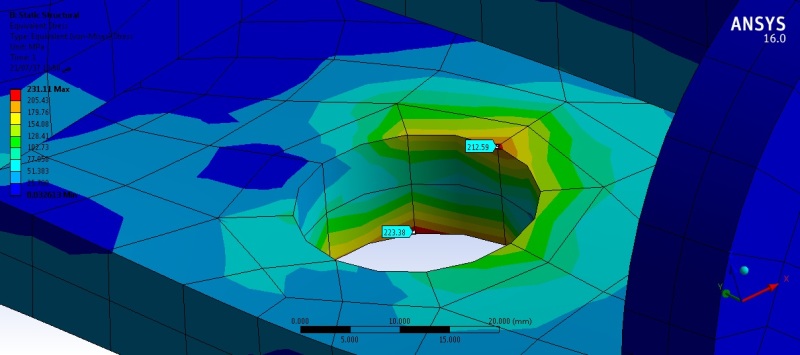

and the max. working stress on this spot:
In reality it will stand on rubber absorber base which its size is twice bigger than the hole size
so maybe the max point are nonphysical.
What do you think?
RE: Calculating safety factor on gear box support
Hi again,
Its hard to comment on your results without knowing all the details of your model. One thing I would suggest is to run a mesh sensitivity study. From your images your mesh/contours look quite coarse. It looks like your primary loading mode is bending and you only have 2 elements through the thickness of the member with the peak deflection. Depending on the element formulation you have used, more elements may be required in this region to adequately capture bending effects. Also, I would try to perform some validation.
Good Luck,
Dave
