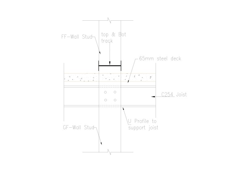

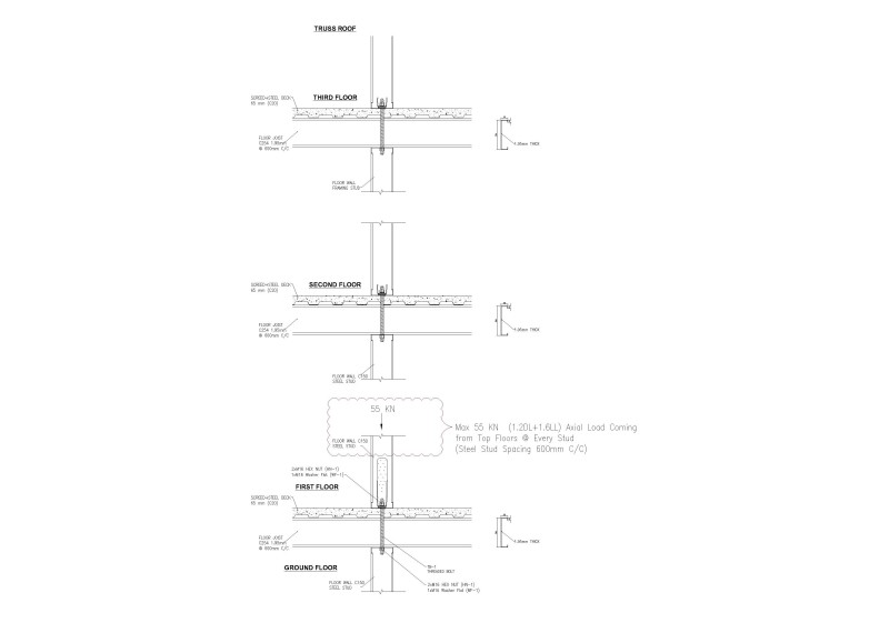

I am design a G+3 Light gauge steel building so below is the load bearing wall connection sketch. Max axial load is 55KN as shown in clouds @ first floor deck which is coming from the top stories , so I have doubt that does the 65mm screed have capacity to transfer the 55KN Axial load to the below steel stud through floor joist safely . Screed is C20 capacity.
Proposed scheme will work without screed damage??
Above and below floors Wall Stud and floor joist are exactly inline.
Wall stud spacing and joist spacing is 600mm c/c so every wall stud is carrying the Approx 55KN axial load.

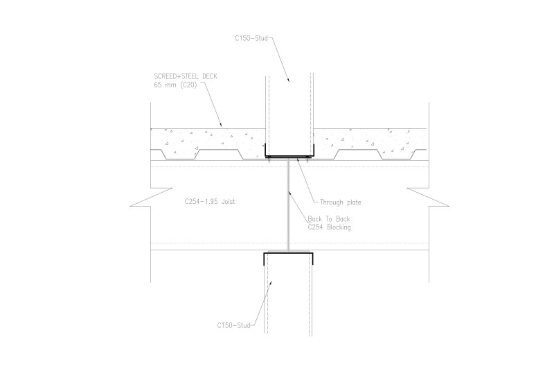

I would be providing full depth blocking between joists at all floors. Then I don't have to rely on the floor system in bending at the supports, just bearing.
RE: Floor Deck/Screed Capacity in Axial Load (LGS G+3 Building)
Thanks for your valuable reply jayrod12.
below is the blocking detail that what i understand from your above comment , my understanding is correct please confirm???
blocking mean to provide one member between joist and below the decking sheet as shown below???
if i provide the blocking then 65mm screed will be safe due to fully support under 50 KN axial load or still i need to check the screed capacity if yes then how i can check the screed capacity???
You've got it. You wouldn't need to check the slab for anything further as long as there is full bearing on the blocking. This may require some additional detailing regarding what to do when a high flute it directly below the walls as opposed to a low flute.

Below is the sketch of kootk idea what I understood. My understanding is correct please confirm, if yes then it is very difficult for site staff because in this case we need to cut the decking sheet at every 600mm (stud location) even if we don’t pour the concrete at bottom/top track location then the slab will be poured separately and there will be no connection between the slab of each room in this case during lateral forces action the slab will not act as a whole. My boss wants to pour the slab once without any hurdle.
By the way my boss is interesting to go with blocking options as I attached the sketch in my previous post and as suggested by the jayrod, because we have already practice this method (no additional training required for labor) in up to G+2 building and got success only difference is that this is G+3 which makes me confused that 65mm screed will take this much load but I think by providing blocking I can fix this problem.
However I know your suggestion is much much better but my boss will never accept, any additional suggestion in blocking option will highly be appreciated.
Sweet. Chalk one up for the blocking detail. But as I indicated, you must ensure that full solid bearing is provided between the blocking and even the high flutes of your deck. This may prove to be a bit of a tricky detail, and even harder to coordinate on site.

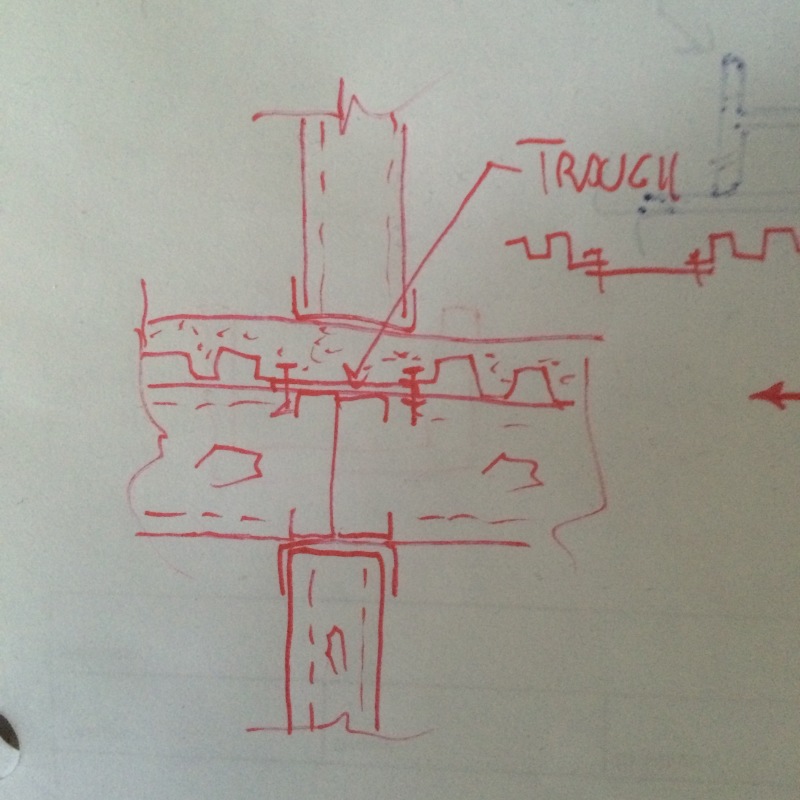

So the detail that we're talking about now is this, right? Deck interrupted by some kind of trough element?
That's what I was envisioning.
I hope i got the better sloution to transfer the load below safely above sketch is very helpfull thanks for your support.
But only one thing is still confuse me that the screed thickness does the 65mm screed (C20) deck(includes decking sheet) is enough to transfer the 55KN stud axial load below without any screed damage or i need to increase screed thickness however i know the screed is act as bearing only and also now fully supported by the blocking but still i am in doubt....???

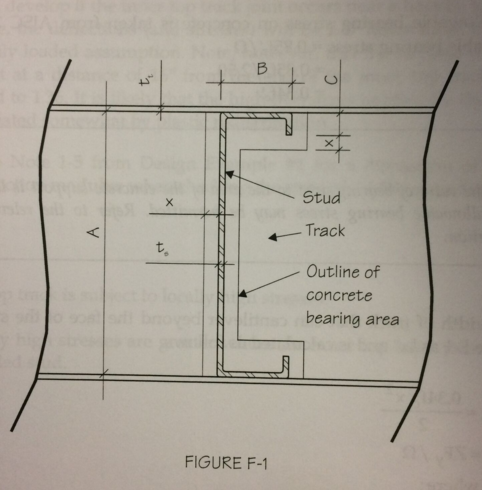

Once you've achieved solid concrete screed below the studs, there are still some checks that remain. And they may be problematic given that 55 kN is about the weight of five Toyota Corollas. In what follows, I've assumed that you'll be lining up your studs above, studs below, and floor joists.
1) You need to check your bottom track as a base plate of sorts like the sketch below.
2) Since the load from your studs will get transferred from the screed to the web of the joists below, you'll need to check the new trough plate thing as an inverted base plate.
3) Since the load from your studs will go straight into your joists, you'll need to investigate whether or not the joists will require web stiffeners. It's a pretty safe bet.
I have analyze all 3 above mentioned checks and everything is working according to my calculation, I have provided web stiffener in joist as it is required.
My only worries is the screeding I slightly modify the detail is that to place my load bearing wall on the joist directly as shown below so which option is better on the screed or on the joist/blocking ??
All walls are shear walls (with strap bracing). In the proposed option the slab will be in parts that can disturbed me in lateral forces action am I rite??
You should sill have a competent diaphragm so long as the trough plate is designed to be part of that diaphragm.
