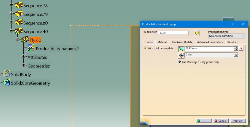

RE: Unable to get dimensions for individual plies separately
Create a core and move it after seq 40. Run producibility analysis with following parameters
As you can see first ply is wider than last. Also try to avoid using the same name for the plies.
This is also working without core. Just check with thickness update option.
I use V5R26. As you can see the interface looks quite different. Interface change comes from V5R25. You can find thickness update here:
http://catiadoc.free.fr/online/cpdug_C2/cpdugut170...
Check With thickness update.

Sorry for the late response. All the time I thought that you are talking about Capitals. My Mistake. Search for a text property for bold text. Never used that.
what happening if you generate new title block? Take a look and links and see if there is any problem.
Its ok, Thank u. U did not tell about the possibility of mirroring composite parts in assembly. What would u say about symmetry of plies in composite module ?
What license do you use? There are two options for mirroring. First is staking mirror (requires CPE licence). You can just create half of stacking and then use mirror (useful for symmetrical stacking). Second one is composite part mirror. With stacking mirror producibility works well, but sometimes you have to run producibility again. I don't remember about composite part mirror using CPM license. I use part mirroring only for laser projection. You can check that with a simple part. Any way if it's not working just run producibility from the beginning. You have all the geometry in a mirrored part including seed points, so this won't take too much time.
I use CPE. OK thank u so much for ur support.
