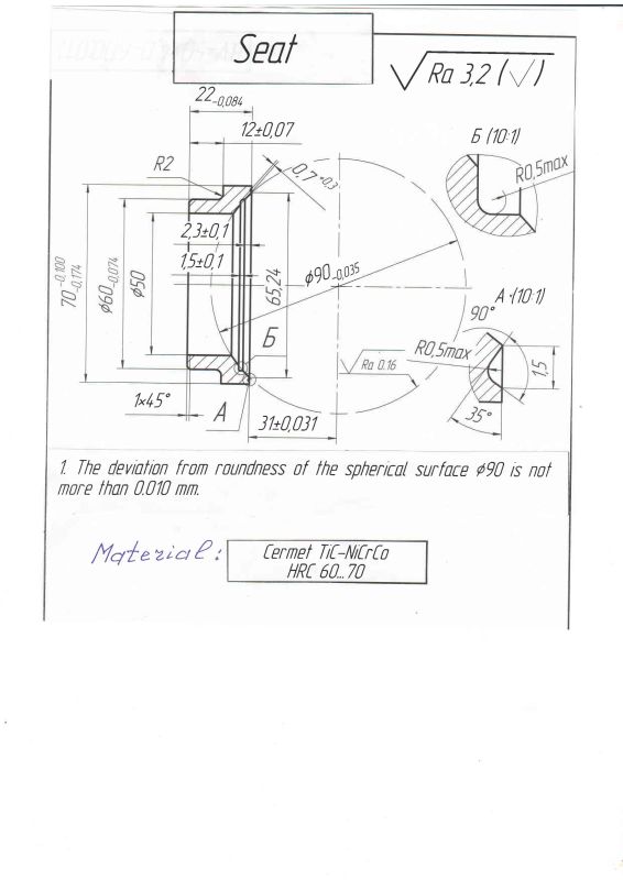

We design ball valves made of cermets based on titanium carbide (binder - steel and nickel alloys) for use in oil refining, energy and mining industry.
There is a problem in machining the spherical surface of the seat. Drawing the seat DN50mm (sphere diameter of 90 mm) is attached.
The deviation from sphericity must be less than 10 microns.

Dear participants of the forum, please help advice on the grinding of the spherical surface of the ball valve seat - image attached.
The diameters of the spheres from 30 to 300 mm.

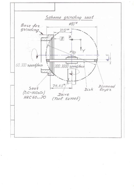

The last 2-3 years I was looking for ways of treating the surface of a spherical seat. The most appropriate method is the grinding, when the workpiece rotation axis intersects the axis of the disk rotation diamond wheel - scheme attached.

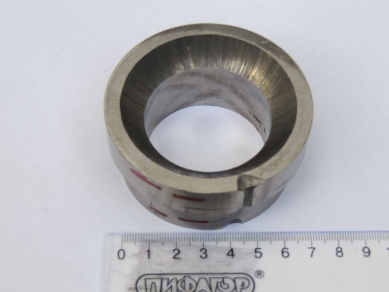

On CNC lathe we treated our billet. In The chuck fastened workpiece. Diamond disc is mounted on a head drive the tool turret.
Photo attached.
We conclude - the method chosen by us, is the most preferred.

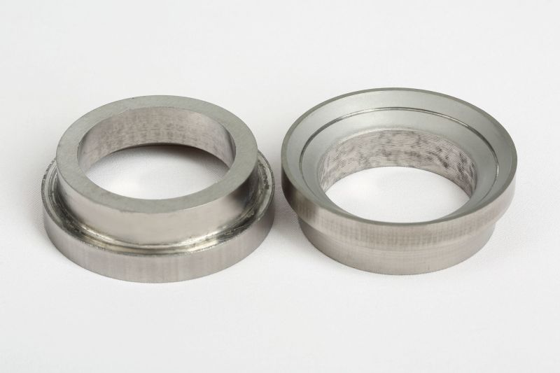

To my best experience the machine lines should be fully concentric (not spiral) and not as shown. All those micro lines shown in the picture are leak paths.

I think you want to swivel the grinding tool on an axis that is not the same as the wheel rotation axis so that you can control the sphere radius generated independently from the wheel radius.

Yes all true. By this method we have not gotten completely treated seat. The photo shows the seat, which is not completely processed.

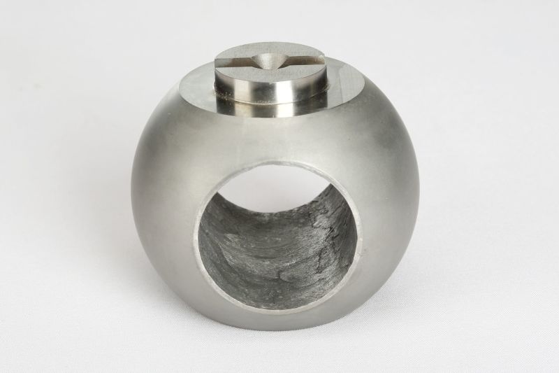

Below is shown full procecced ball valve.

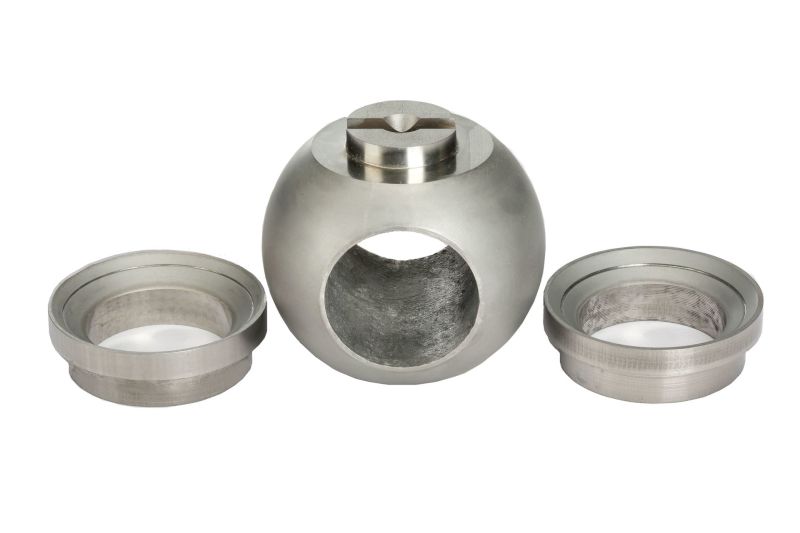

So far, for the treatment of the seat we use the electrochemical method of processing (electrod-tools) and grind it to a ball - see photo.
Full redy ball valve is shown below.
Compositepro:
"...the sphere radius generated independently from the wheel radius..."
That's right - we are convinced of this, and processing circuit analysis shows that this is so.
If the diamond blade have wear, the by moving along the axis Y we get the same scope 90 mm.
This treatment scheme has long been known.
In the absence of tool wear, the intersection of the axis of rotation of the details and diamond disc, of absolute rigidity of the machine, we have an ideal spherical surface.
