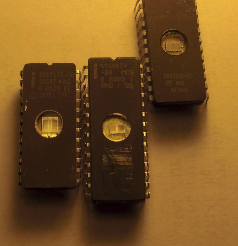

Does anyone happen to have the data sheets for a couple of old (late 70's early 80's) Intel EPROMS?
The numbers are:
4917175-00
4918424-00
Oh, almost forgot, and a Motorola EPROM:
2892292-00
Any help, or a point in the right direction, would be appreciated.
Thanks,
David

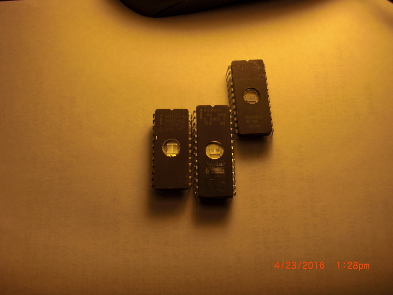

Sorry about choosing the wrong forum. But these chips look like they have the Intel 'i' and they do say Intel. I'm familiar with Intel's 27 series and SEEQ's 52B series, and XICOR's X28 series, but I'd never seen these chips till I found them in a pile of wires and caps and resistors at a garage sale. The photo was uploaded from Windows Photo Viewer.

Sigh.. We wanted to see the picture so we could integrate everything we know/still remember into what the labeling was. Giving us a poorly lit non closeup of the markings doesn't really help.
Keith Cress

RE: Looking for some info on some old EPROMS...
Is this better?
That was a useable picture thanks.
Sorry but you'rescrewed as those are likely OEM numbers as IR speculated. I believe those are pre-programmed EPROMs by Intel and the number is something like the contract, service, or part number to keep track of the fact that they're programmed and who's program it is. The markings are put on by Intel and since the chips are tested then immediately programmed there was no need to identify the type chip only the model/code.
That would explain the strange numbers! I'll plug them in to my old reader/programmer and see what they look like.
