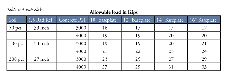

I have information/data/cut-sheets from (2) competitor suppliers of 2-post vehicle lifts / hoists with capacities of 10 & 12K.
Both suppliers recommend only a 4" concrete slab. When asked about a moment at the base, a rep told me that the anchor bolt layout disperses the moment. How do these slabs NOT fail? What am i missing?
Myself and a colleague both come with 12" of each other in preliminary design in the neighborhood of requiring a 6'x8' footing.

I'd check what their assumptions are (in particular their assumed edge distance and subgrade modulus), and see if you agree with them.
RE: Foundation / Slab For Vehicle Lifts
Not so bad away from the edges. Link. Obviously the anchor bolt spreading business is layperson clap trap.
