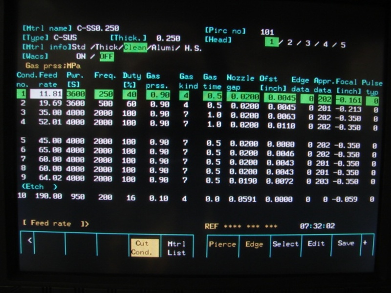

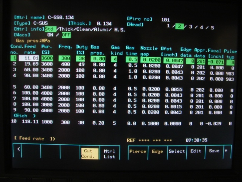

Hi all,
Could someone please post the cut conditions of parameter for SS304 1/8'' and 1/4'' Thick (Feed, Power, Freq, Focal, ect. ect.) I want to see where my conditions match with yours because i am getting a poor cut.
Thank you,
JT.

hi evans1089,
we are using clean cut Nitrogen for stainless steel.

hi jjl1210,
Thank you for your reply but the power of our machine is 1500w, should I increase the duty to max.

I would change all the 4000 to 1500 power and reduce the feed by 60% as a starting point. I started with a 2000w laser never 1500w but this is what I would try first.
RE: Need Help on Parameter setup for SS304 1/8'' and 1/4'' thick (Amada LC1212, Lens 5mm)........
Our 1500W for 1/4" was wide open and feedrate of 10 to 15. I would do a focus test and then try a different focus when cutting. Ours was -1.5 to -2.

Hi striker12300,
Thank you for your inform, i put my focal -.79 on lens 5mm but the burr is still at the bottom of sheet metal.
I will try different focal BTW can you post your Pierce & Edge setup screen for me.

Hi striker12300,
I will change the parameter setup and play around with it.
