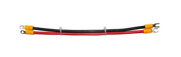

Can you provide a picture? It sounds like an interesting challenge :)

RE: Wires with lugs in assemblies
Like this but just single wire. Not two like on image.
And with any terminal that looks like these:
