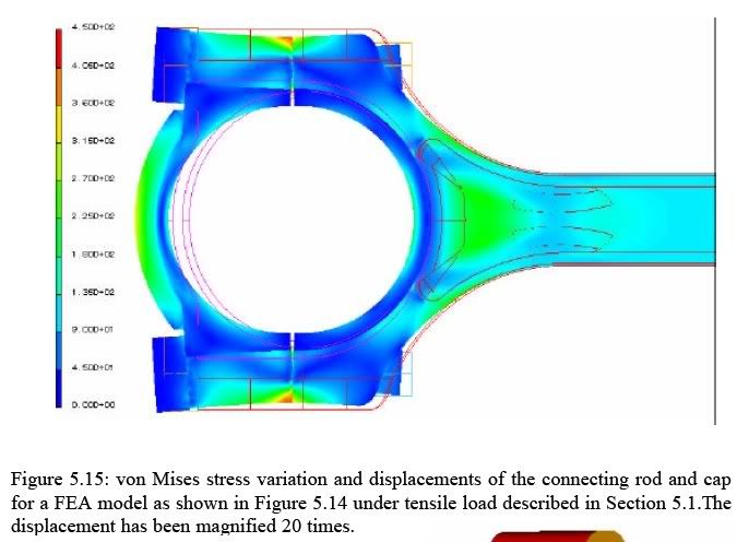

I have a situation where I need to calculate the stress on a rod bolt. I have a 3/8-24 rod bolt which is torqued to achieve a bolt elongation of .006" as measured with a bolt stretch gauge. I have calculated the inertial load at the max rpm and I want to add that to the clamp load to get total load and then stress on the bolt. I’m using the equation:
dl = (F*L)/(E*A)
rearranged to
F=(dl*E*A)/L
My question is what number should I use for L? Should it be distance from under the bolt head to the first thread? To the middle of the threads? To the parting line of the rod cap? It makes a significant difference in the final stress.
For A, I’m using the smallest cross section of the bolt which occurs in the shank. I attached a jpeg with a cross section of the bolted joint. This should be a fairly simply calculation but this one detail is tripping me up. Thanks in advance.

"I have calculated the inertial load at the max rpm and I want to add that to the clamp load to get total load and then stress on the bolt......."
If you are planning simply straight addition of clamping force plus inertial load to "calculate" bolt load I think you will severely ( and incorrectly) over-estimate the resulting bolt load.
The slightly over simplifed situation is, the loading experienced by the bolt will not increase until the preload is overcome and the rod/cap parting faces separate.

Then there is the "prying" action the bolt will be subjected to as the con rod big end deforms at high rpm exhaust TDC.
Along the lines of this -
http://img.photobucket.com/albums/v14/SaabTuner/Vi...
http://garage.grumpysperformance.com/index.php?thr...
As far as effective "L" I'm thinking it is a little less than the distance from bolt head face to approximately the first thread. The variation in diameter really limit the use of that formula, unless I solve it as a bunch of pieces
