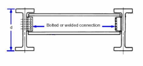

Hi there,
I'm based in uk and have done some calculations to size beams to replace a load bearing stone wall
Wall thickness is 530mm so approx 500mm stone/mortar wall excluding render.
I have sized 2 off 203x203x 46 uc beams. This only comes to 406mm total width.
I'm not sure whether I should specify 250mm wide top plates for each beam (totalling 500mm) to ensure full contact between wall and beams. Or whether the 100mm overhang (spread over 33mm either side of each beam) is acceptable. I can find no guidance in specifications for this.
Would I be able to use a top plate if I could get away with 2 times smaller 153uc beams, as these would be much narrower.....
Any thoughts? apologies if this is a simple one, but I cant find the solution in any of my books or online.

Hmm, a top plate tying the two beams together would certainly make a nice lateral bracing system for such a heavy load. Any rotation or kick out would be covered in addition to providing a nice grouting surface to get the contact between the beam and stone wall.
Are you going to preload the beams somehow so that the initial deflection doesn't produce the typical diagonal portal cracks?
RE: steel beams for thick wall.
Wilko78 - Glad you found the error. The (US) Brick Industry Association has a technical note on Structural Steel Lintels. It is good advice for any masonry project. They recommend limiting deflection to L / 600 or 8 mm (maximum).
Since we don't know the loads, I can't comment too much on beam selection size. However, I disagree with what seems to be your priority - maximum flange width. IMHO, it is better to select beam size based on web depth, without regard for flange width - to limit deflection as much as practical. Place the beams so that there is no overhang at all. Span the gap and cover the top of both beam flanges with a 500 mm wide steel plate of suitable thickness. Weld the plate to both beams. Providing maximum spacing between beams will help with resisting any eccentric loading on the wall.
Limiting deflection is important, per the technical note. But it will also help load sharing between the two beams. Any differential loading on one beam creates a magnified problem. As load on one beam increases, load on the other may decrease. The result, as one beam's deflection increases, the other beam's deflection decreases, causing wall tilt be twice what would otherwise be expected.
Another step I would use is to tie the two beams together with a few diaphragms (say 3 or 4).

We've been through this before. Check out this thread: Link. Be sure to review the attached sketches as well.

I disagree a bit.
1) I don't think that there will be space between the beams to install meaningful rollover beams as diaphragms without contructability issues. I think the top/bottom plate concept from the other thread is the way to go.
2) I think that some degree of overhang is actually desirable as it will allpw for some field tolerance in the positioning of the beams.

Wilko78 - When you select the new beam size keep in mind that you are not designing for moment, but for deflection under code-required maximum load combination:
L /688 (8 mm deflection over 5.5 meter span).
The moment in any beam size that meets that deflection criteria will be so low (compared to the beam's maximum capacity) that LTB will probably not be an issue for a 5.5 meter span.

Hi all,
so I have selected a 356x171x57 UB
this supports the full load independently, so doubling up the beams provides alot of redundancy and covers the TIF factor (Things I forgot).
it meets the L/360 requirements for Eurocodes (for beams carrying plaster) so I think the deflection is OK (limit is 15mm and I get 15mm)
Where does the L/688 come from?
As for the installation i like the idea of the stiffeners. Not sure how practical they will be to install.
As for top plate, with such narrow beams I think i need to suggest them. it will definitely be needed if the stone wall has loose infill (only determined when work starts). ....

Hi guys,
OK, I must apologies, I hadnt linked the L/688 to the 8mm for my particular span. I was looking within the document for the actual ration L/688. I do appreciate the support (pardoning pun) you guys have provided.
Well the 8mm is certainly something new to me, with my 15mm deflection I'll take a look through and see what can be done as i'm about double the guidance in that document. Both the British Standards and the Eurocodes dont mention a specific value for deflection. However I am always learning and certainly am not going to ignore good technical guidance. particular where safety is involved.
406x178x74 meets the deflection requirements of 8mm (7mm deflection).
sequence of construction I would leave to the builder, however as an engineer I should "design it to be built".
my preference and my guidance on the drawing would be to lift one beam in at a time. resin anchoring first beam to a padstone and allowing to cure. padstone will be set on the existing 530mm thick wall or possibly new engineer brick column if builders find loose masonry.
repeating for next beam. I was going to use CHS spaced at 600 centres along the length of beam to maintain uniform installation. however the stiffeners would negate the need for these. I do like that detail and would probably suggest it.
I have a suspicion that a deeper beam will be too much for the client (head room) and that the compromise will be a shorter opening....
I've been extremely conservative in the load assumptions, but with old stone walls, I'd rather not assume a nice simple loading scenario and two beams supporting weight provide the bearing capacity which will allow me to sleep at night.
I want to minimise site welding, so perhaps have the top plate tack welded to the top of one beam prior to installation. then other beam sit underneath that plate....

I was thinking that Acroprops and "strong boys" would be used to support load, while enough of wall is demolished (and piers built) for the new beams. Beams would be installed one at a time. Once ready, the strong boys would be removed one at a time, and the gap packed out in sequence.
The two beams offer support across the mean of the wall thickness. I dont feel comfortable assuming that the load will be directly beneath the centre line of wall, so full wall thickness support is needed.
By assuming this I suppose I could have halved the loads, and looked at reducing the beam depth, however as has been pointed out by those that responded (thanks again) I needed to pay extra care to the deflection in masonry. Plus I am a Civil Engineer by training and we always like to include alot of redundancy smile
I will need to speak with client and ask if the reduction in head room is acceptable. The architects drawings show no elevation in their plans.....SO its either reduce head room or reduce opening width. Even if he was accepting of the reduction in headroom, I dont think there will be enough masonry left above the supports (due to roof line) to be acceptable regardless.
Do you think a top plate would be acceptable or just a little too much overkill?

Hi Tony1851,
after taking some guidance from the responses I received, particularly with respect to the deflection limits, I ended up with the following:
limiting the opening to 4.8m. this was more to do with the available clearance above the beam (conflict between roof line and the new beams).
2 off 356x171x67 UBs
with 3 off 203x133x25 UB stiffeners
10mm plate welded to top of beams 500mm wide, to provide full support accross the cross section of the opening.
padstone was also selected.
