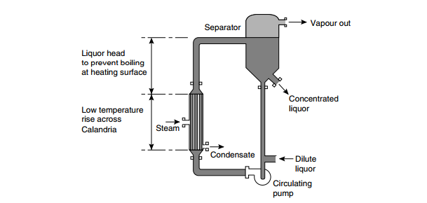

What is the max slurry concentration one should design using for a Shell and Tube HEX? The duty is as the Calendria of a forced circulation evaporator. Any guidelines based on what has worked in the field in the past experience? Above what concentration will I be facing operational / fouling / plugging problems?
The S&T is two pass on the tube side with 6000 mm long tubes with 1.25" dia. Mounting is vertical with a 3 m/sec liquid velocity.
What is the max conc. I should allow for in a conservative design? Any tips / heuristics? The solids are hard & crystalline NOT fibrous / slimy or pulpy.

I'm thinking of very conservative loading. Say 5% solids conc. But I wanted an opinion from others. Is this too low a loading? The lower I want to keep the solids conc. the sizing of the solids removal loop increases.

Not sure if downflow would work: This is a calendria for an evaporator. There is suppressed boiling in most of the tube length due to the liquid head above it.
But in the last parts of the tubes we have a vapor liq mix that then directly enters the vap liquid separator mounted next to it.
Something like this sketch below (but with 2 passes)
I could do a single pass though. Only reason I didn't was that single pass makes the pump size 2x to give the 3 m/sec velocity.

You need to look at single pass, up flow, with smaller diameter tubes.
I know people running in 5-10% solids range.
Worry about heat transfer and handle erosion with material selection.

The sketch implies single pass or multiple odd passes only, and I dont see how you can set this up for 2pass tubeside flow.
Since you have a constant recirc pump, if the solids are small, you may be able to get away with high tubeside velocity and high piping velocities. Then again, there may be solids settling out in dead spots on the tubeside channels.
Else make provisions to accumulate these solids at some low points in this recirc loop for automated live or offline removal - can get messy.

5% solids is not particularly high for a shell and tube heater. In some cases operating at significantly higher slurry densities (e.g. >25w/w% solids) can be beneficial via hindered settling. We routinely operate slurry heaters at 40-50w/w% in 25-32mm tubes. The larger tube sizes are an advantage as they clear (water jet) more easily.
Horizontally mounted tubes are easier to water jet and retube (better access).
