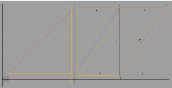

1) See attached screenshot of the strut and tie model - basically a cantilever wall.
2) I've also zoomed in on the node and shown the CORRECT forces - I would be interested in your take of how I treat nodes with more than 3 forces as i'm fairly new to this type of analysis.
3) The shear arises from the fact that the surface of the node is not perpendicular to the strut force (non-hydrostatic). The strut force therefore is broken down into a normal force and a shear force.
4) In this case I have five compression forces entering one node, hence I have a pentagonal node - I break this down into 3 triangles to allow me to work out the principal stresses in the node.

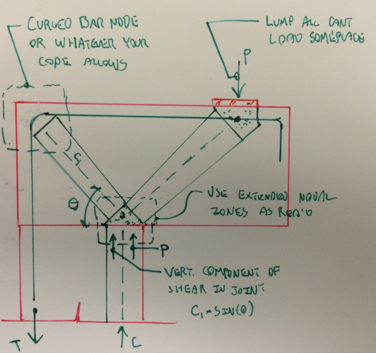

I'm glad that you've got it sorted out handoflion. Before we close off, I'd like to propose an alternate model that I believe would have some significant advantages including:
1) Simplicity. No CCCCC nodes.
2) Rational reinforcement layout. No need for diagonal reinforcing at member one.
Below, I've shown your model and mine for comparison's sake.
RE: Strut & Tie Modelling: Nodal Stresses & Mohr's Circle
Yes would love to avoid that CCCCC node haha, but there was one little bit of information I left out that means I need the two struts as shown. The wall turns the corner (by about 30 degrees) at nodes 4 and 5 (see attached 3D model). I'm taking out the out-of-plane forces in the slab diaphragms above and below. Is there an easier way to deal with CCCCC etc. nodes? I suspect not... sad

Cool. The same simplification still applies at the compression reaction and left of the compression reaction. Death to the CCCCC node.

Actually, even with the simplification, you might still be stuck with a 4C node. Tackling the two nodes at the bend looks like a nightmare. I'd be inclined consider this as two separate trusses that only have shear connection at the bend. That would get you back to a 3C and eliminate the difficult analysis and detailing at those two tricky nodes. The down side is that your slab reactions would jump up a fair bit since the moment formerly delivered from the dogleg to the backspan would need to go 100% into the slab couple.
