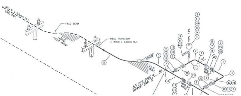

An ILI found dents >6% deep near 3 of our underground guides in a double S-bend riser for an NPS 6 pipeline. The dents are located at the 6 o'clock position. Verification digs will be performed in a few months, but we are thinking it is either caused by rocks (not likely to have caused all 3 dents), the support falling off the guide or the support piling has moved.
Has anyone else come across a similar situation with a different cause for the damage? Corrosion does not appear to be a significant factor.

What in gods name is an "underground guide"???
Buried pipelines should be continuously supported by soil. Introduce hard points /point loads and you have huge trouble..
Can you sketch this or describe it better please.
RE: Bent Pipelines
The guide is a pipe (piling) with an I-beam on top and two 2" pipes welded on each end to prevent the lateral movement of the line.

I've seen this on numerous occasions on tool runs and it is almost always caused by underground supports. My company expressly refuses to accept the use of underground supports like this to the differential settlement between the support and the bottom of ditch which leads to this issue.
RE: Bent Pipelines
canadapipe, thanks for your response. That is what we were thinking too. Since the lines are resting on top of the support I would think that the dents at the bottom of the pipe are likely caused by the support coming up.
The ILI data indicates that it is right where the support is, but we don't have verification of where exactly it is.
RE: Bent Pipelines
I am astounded. I have never seen anything like this before for exactly the reason you've found. What on earth was this monstrosity installed for?? Looks like a piping designer who didn't know a thing about pipelines installed this.
These should be removed forthwith and never installed again.

Just to add confirmation, I have seen this exact scenario before, and guess what, the dents are always right at the I beams. I have even seen this scenario play out, and what happened, oh there are dents, there is not enough support here, better add more I beams, and guess, what, more dents.... anyway, my recommendation would be to remove, you may be able to put a sleeve over the dents resting on the I beam, but not sure that would work in the end, you still have a similar problem

Not usually. It is the settlement of the soil either side over time which then leaves the pipe attempting to hold up the soil above it. Not surprisingly for such a small pipe it can't. Therefore the pipe bends.
The risk for any point load or differential settlement is a shear failure causing a complete rupture.
I remain absolutely astonished that a few of you seem to think this is somehow "normal practice".
Whoever started this, which then somehow got moved onto the next project as something that is normally done needs to cease pipeline engineering and go back to piping where they belong. Is this a strange Canadian thing? Wherever it comes from it needs to stop - I though anchor blocks were bad enough, but "Underground guides" are far far worse. Think yourself fortunate that you only have a dent - it could easily be much worse.

The pipeline is built through soft soil (i.e. muskeg). I think the supports were put there to limit the settling of the pipeline which could have caused dents in the riser pipe aboveground.
If we remove the supports, what can be done to ensure that the pipeline doesn't settle excessively and cause dents elsewhere?

Generally the only successful option is to excavate down to something quite hard, build it back with rocks / stone etc and then lay the pipe in or on that surface.
Not great ground normally but then I assume the AG section has some good foundations?
Differential settlement is not good news for any type of pipe, but putting supports there just makes it even worse, especially for small diameter, thin wall pipes like you have.
The key is to put in sufficient material to prevent differential settlement, monitor the situation and allow some flexibility in the incoming pipe.
Either that or extend the supports and make it an above ground pipe.

Making the supports taller. You either remove the supports and do something else to support the pipe on a contiguous support basis instead of point supports, or lift the pipe clear of the ground.

Yes, it's still a terrible idea. Get rid of the supports. That's the root cause of your trouble. Messing about with them won't help.
