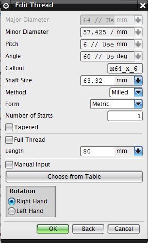

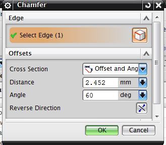

In drafting, in some features, thread is not visible. I have uploaded a snap in the sequence of creation.
step 1
Created the counterbore hole with the specifications as in the image.
step 2
added symbolic thread to the counterbore hole.
step 3:
added chamfer to the above.
Step 4:
drafting representation of the hole.
Kindly tell me why is the thread is not displayed in drafting in step 4.

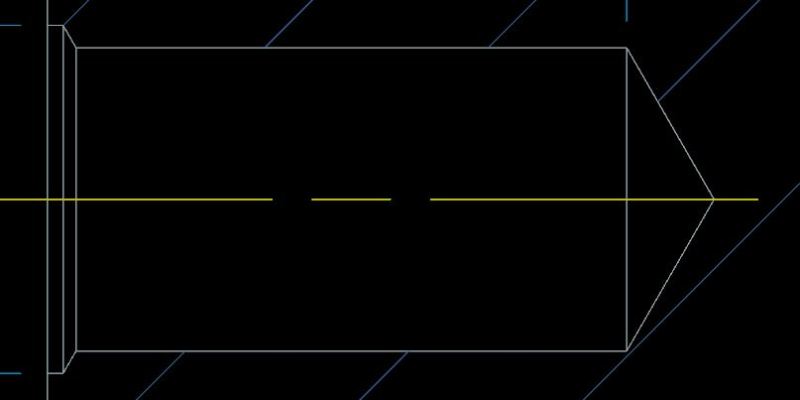

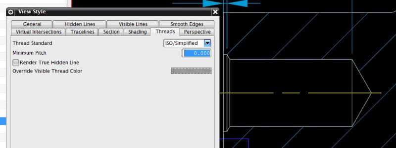

Thank you for the video. I am working in NX 8.5. I am still not able to get the thread. I have attached the snap of it below
RE: Thread display issue
One step I missed.. instead of subtracting the hole from the body in step 1, I am doing a separate subtract feature after the chamfer. would that be an issue?

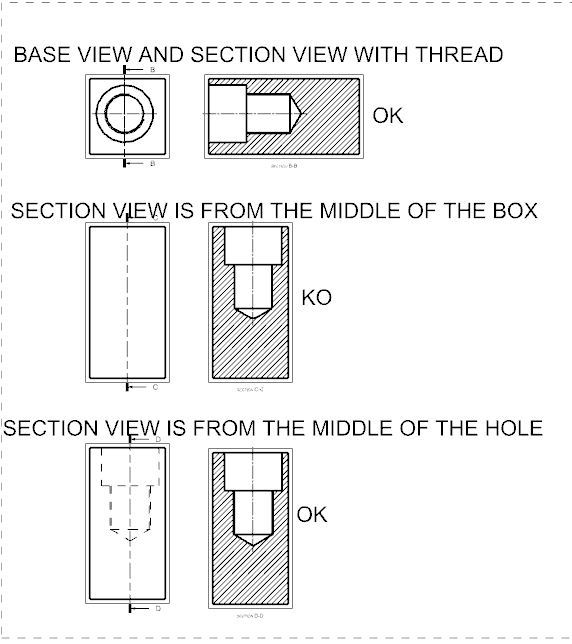

Question, is it only Not showing in section cuts? Can you see the threadcurves viewing the hole from Top?
When you make a sectioncut of a Hole feature you need to make sure it goes directly through the center. Otherwise it will not show the thread curves.

Forget about my last answer, I think is not the problem.
I´m tryng to reproduce this error in NX8.5 (I usually work with NX10)
Could be just that you are not doing the section from the middle of the hole?
Look at this example that I´ve done.
