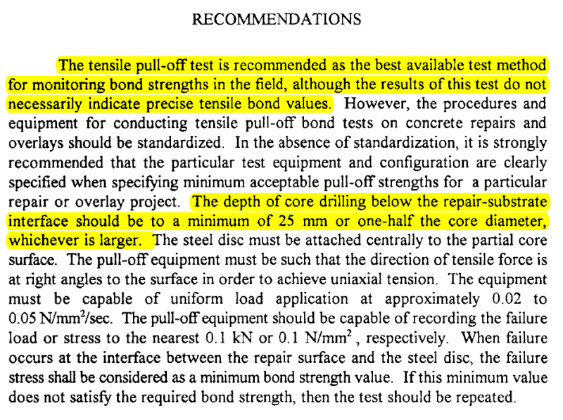

I have only used slant shear testing on epoxy adhesives, and the test is a pain to conduct, even in a lab setting.
I did find this reference from ACI in my files: Evaluation of Procedures for In Situ Tensile Bond Testing of Concrete Repairs by J. E. McDonald and A. M. Vaysburd, with the following recommendation pertaining to tensile pull-off testing:
