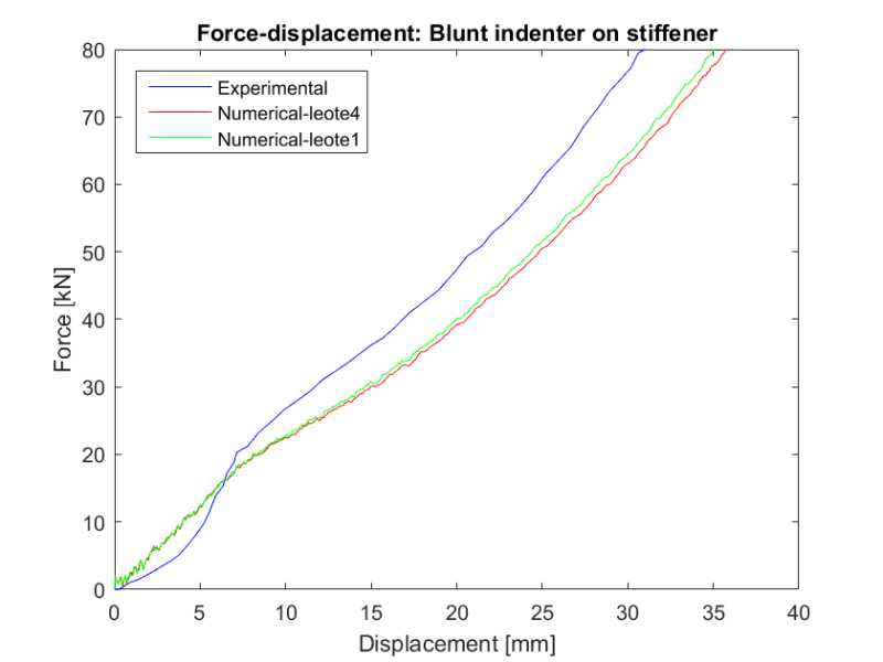

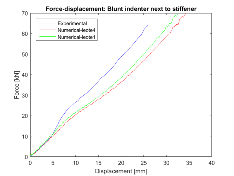

I expressed my self a bit unclear in the first post. The structure seem to be to stiff as long as the indenter hits the plate between the stiffeners, but too soft if the plate is hit on or close to the stiffener. (See the plots below. Leote4 = 20mm mesh and leote1 = 5mm mesh)

I agree to that, if there is plasticity. Otherwise I do not see the reason. Elastically should be fine.
Plot number 2 looks good up until 10 kN, right? What happens around 10 kN there? What kind of strains do you get? Is it maybe correct up until somewhere around yield stress? It should be cause the material data should be fairly accurate up until that point, imo.

Plot number 2 (indenter next to stiffener): As you suggested, something happens at approx. 10kN. I have checked the model and there is at this point plastic strains start to arise in the stiffener which also confirms your "theory" that the model is correct up until yield stress. I will go through my material card and check for errors. Maybe I got my power law-parameters messed up.
A point (which I also failed to mention earlier) is that the experimental data I am comparing my results with are from a doctor thesis written in 2002 and no material parameters are provided for the stiffeners - which implies that I have used the same parameters for the plate and the stiffeners. Consequently, this is not that good of an estimate since the structures are made up from extruded aluminium profiles. Still, I don't think that explains all the difference alone.

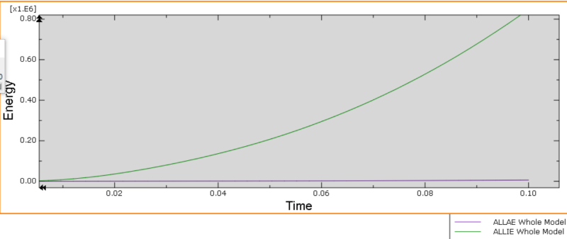

I don't have that much of experience with hourglass control, but I know that the artifical energy should be small compared to the internal energy. Below is a plot of ALLIE and ALLAE. Does this seem okay? Artifical energy stable at 1*e^3 and the interal energy has it max. value at 850*e^3. The link you provided suggested a threshold value of 1%, but for how much of the analysis is this "valid"?

I haven't worked that much with explicit so I am not certain about the energies. I suggest plotting all of them in excel and just go through them and identify those that you know to begin with (like kinetic energy). My guess is that for slightly lower impact speeds, Implicit dynamics could be easier to use (replace step).

(FYI: I am using double precision for the solver and the analysis is completed with 5 elements through the thickness. I couldn't find any aberration in the energy quantities, which (hopefully) indicates that the model is working they way I want it to!)
