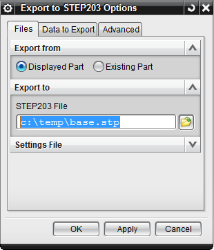

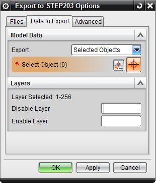

First, build your assembly in TC/NX (as you normally would, either separate or even all components in one file). You then want to Export... STEP203...
Give a file name (and external location), then...
Select only the components you want in that file, ie; "base". Repeat this procedure for your different "delta1", "delta2", etc configurations. Send the resulting .stp files to your vendor.
You can check your exports by launching NX 'native-mode' (without TC) and File -> Open... these files, changing your file type .prt to .stp.
