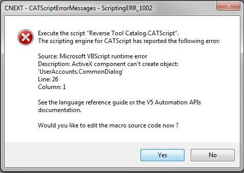

Hello,
I'm new to the forums so I need a little direction. I have a .CATScript file that I know worked in either older releases of V5 and/or prior to Windows 7. I am getting errors now and am wondering if this is a place I can get some help with this. I don't have any experience with Visual Basic but need to get this project going while I'm trying to learn. If this is not the forum to get this help, please let me know.
Thank you.

RE: CATIA V5 Catalog creation using .CATScript
Fernando,
Yes I did. I actually found the first article that shows up in your link. I tried some of the code but being a complete newbie on VB I just couldn't get it to work. I was just hoping to find someone like me, a CATIA user that's already gone through the problem.
Interesting problem, it took me some time to figure how to do it (with help from Google, of course smile).
Is not the whole code, is just that part till changing the extension of the picked file from txt to csv and catalog.
CODE --> CATScript
Language = "VBSCRIPT"
 Sub CATMain()
 Set wShell=CreateObject("WScript.Shell")
Set oExec=wShell.Exec("mshta.exe ""about:<input type=file id=FILE><script>FILE.click();new ActiveXObject('Scripting.FileSystemObject').GetStandardStream(1).WriteLine(FILE.value);close();resizeTo(0,0);</script>""")
sFileSelected = oExec.StdOut.ReadLine
Set objFSO = CreateObject("Scripting.FileSystemObject")
Set objFile = objFSO.GetFile(sFileSelected)
  szOpenFileName = objFSO.GetFileName(objFile)
' Check if file name ends with ".txt".
  If (Right(LCase(objFile.Name), 4) = ".txt") Then
    ' Rename the file.
    strOldName = objFile.Path
    strPath = objFile.ParentFolder
    strName = objFile.Name
    ' Change name by changing extension to ".csv"
    strName = Left(strName, Len(strName) - 4) & ".csv"
    strNewName = strPath & "\" & strName
    ' Rename the file.
   objFSO.CopyFile strOldName, strNewName
       ' Change name by changing extension to ".catalog"
    strName1 = Left(strName, Len(strName) - 4) & ".catalog"
    strNewName1 = strPath & "\" & strName1
    ' Rename the file.
   objFSO.CopyFile strOldName, strNewName1
  End If
 szSaveFileName = strNewName
 szCatalogFileName = strNewName1
 MsgBox szSaveFileName & "     "  & szCatalogFileName
End Sub
