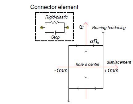

Hi
can anyone please advise me to define connector ellements with following details:
Using rigid plastic CARTESIAN element and a STOP element in parallel and The connector behaviour must be:
1- rigid up to the slip force limit Rn
2- slip at the bolts up to ±1 mm at constant force Rn
3- rigid bearing hardening
Thanks.
