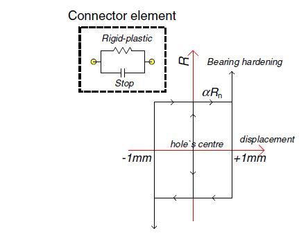

can anyone please advise me to define connector ellements with following details:
Using rigid plastic CARTESIAN element and a STOP element in parallel and The connector behaviour must be:
1- rigid up to the slip force limit Rn
2- slip at the bolts up to ±1 mm at constant force Rn
3- rigid bearing hardening
Thanks.

1 and 2 can be done approximately with a nonlinear elasticity
3 with a connector stop
