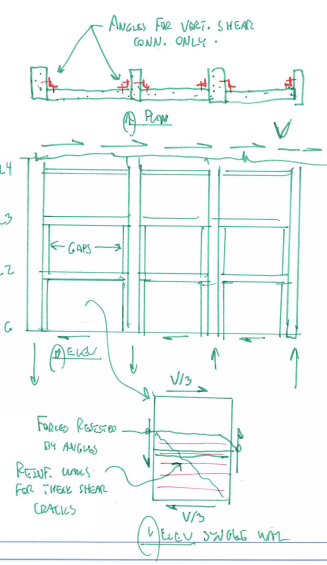

Obviously a "do nothing" approach should be explored if it has merit. I've no doubt that you've already considered and rejected that however.
I believe that you could get away with just a vertical, bolted angle shear connection between the walls and columns, similar to what might be done in a precast scenario.

Regardless of gap or not, it's likely that Koot's proposed repair would be the easiest to design and quickest to install. In my books that generally means it's the best option, however there may be other constraints at play.

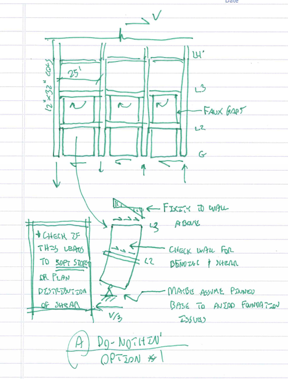

I've trying to think how I might approach a "do nothing" solution here. The sketch below is where I end up. I don't love it for anything seismic because of the potential, vertical stiffness irregularity that results.

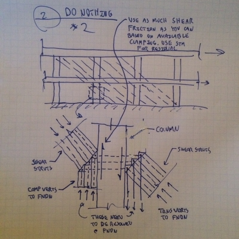

This is the best that I can think of for a pretty concrete option. Issues:
1) Might bite into parking stalls.
2) Might not be able to develop dowels for Fy shear friction. You'd have to cheat it based on prorating or use an alternate shear transfer methodology.

I'm waiting to hear from Ingenuity (OP) and see what the feedback might be on the suggestions offered.

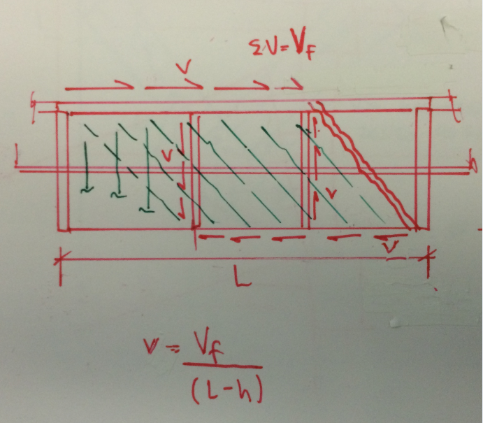

@RHTPE: here's another "do nothing" option using squat wall methodology and inspired by your suggestion regarding diagonal strut formation. It's digging pretty deep but within the realm of plausibility I think if there's enough vertical reinforcing in play.

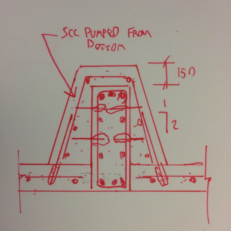

Another option was new 12"x12" concrete elements at the wall/column corners, as follows:

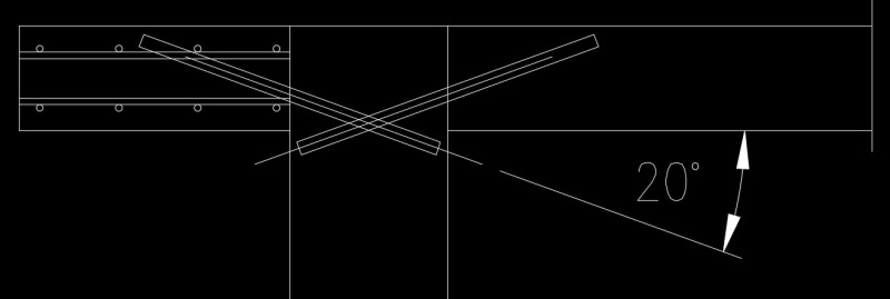

I have looked at the 3 segmented walls similar to 'infill masonry' walls, developing diagonal struts as RHTPE first described, and Teguci referenced. I briefly checked STM with ACI-318, but quit when I looked at the strut angle on a floor-to-floor basis where the angle was less than 25°.

You could go with two story struts to improve the angle. You'd still be stuck with some detailing issues at the ends of the struts as RHTPE alluded, particularly at the top.

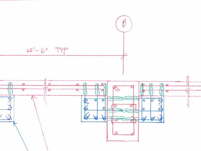

Epoxy bars in something like this if you can map the existing rebar well. #8s are possible but #6 would probably be more practical. Don't want to go smaller due to the long length that needs to be drilled.

Teguci: Thank you for the sketch. The column rebar spacing may be problematic to make the drilling/grouting of dowels a viable option. I will see what the GC says.

Based on the proportions of your wall, I feel that squat shear wall treatment is appropriate. As such, I'd look at it as shown below. Depending on how your went about your VQ/I (cracked, uncracked, etc), the difference may be slight.
