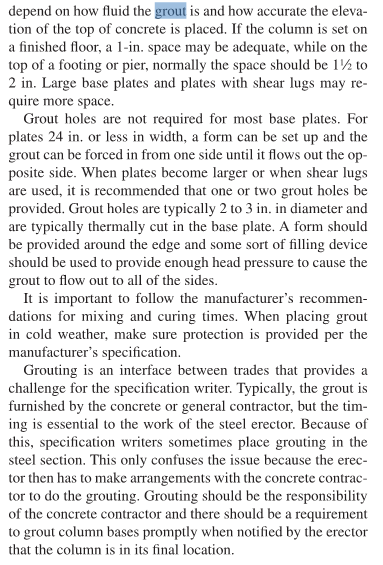

AISC Design Guide 1 - "If the column is set on a finished floor, a 1-in. space may be adequate, while on the top of a footing or pier, normally the space should be 12 in.
to 2 in. Large base plates and plates with shear lugs may require more space." pg 9

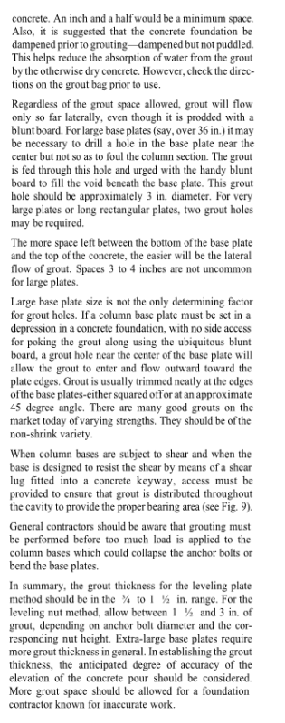

I was always taught it's based off anchor rod diameter, so I use 2" thickness up to 2" anchor rods and switch to 3" up to 3" diameter and then go to 4" grout thickness. I have no clue where it was developed, but it my firm's in house "policy".

First edition AISC design guide advice is first blurb below. The next two blurbs are from the first edition which is, surprisingly, more helpful.

In our office we use 1.5 inches of grout for 3/4" anchor bolts, and 2-2.5 inches for 1"-1.25" anchor bolts; just to allow for enough space beneath the plate for the bolts. A phone call saying there isn't enough room for the plate + leveling nuts (and plate washers if applicable) is not a phone call you want to get. (I once had this happen to a coworker at a previous internship)

We use leveling plates around here a lot, so we usually have 3/4" grout bed below the leveling plate.

Check with the grout manufacturer. I think you will find there will be limits to the maximum thickness. If the grout is too thick the heat generated can cause even more rapid curing that causes issues. Extra stone/aggregate can slow the reaction and help with borderline situations.
Epoxy grout is especially vulnerable.
ACI and API have some pretty specific recommendations.
Rotating machinery is particularly critical. I would NEVER leave leveling nuts on the anchor bolts, since tightening the upper hold down nuts later would not clamp the base against the grout

I prefer leveling plates to minimize the grout thickness, as I think structsu10 was getting at. I think the workmanship tends to be much better with leveling plates. I have watched many different contractors dry pack under a base plate that was set with leveling nuts and the quality of grout pack is often suspicious.

If I remember correctly, it basically says that 2" is the recommended grout height for plates up to 3' wide and to increase this grout height 1" for every additional three feet of width.
