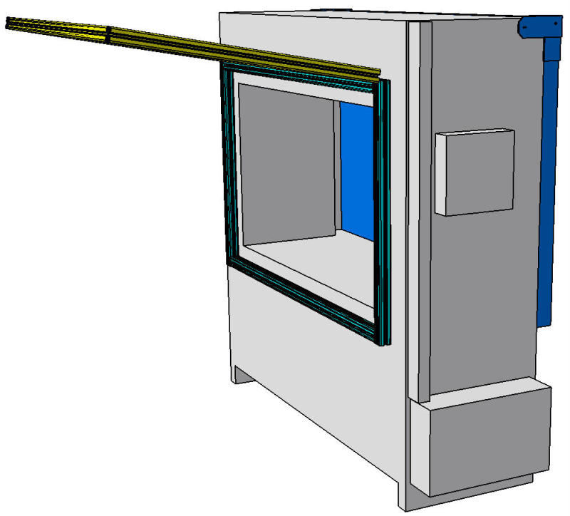

Hey all,

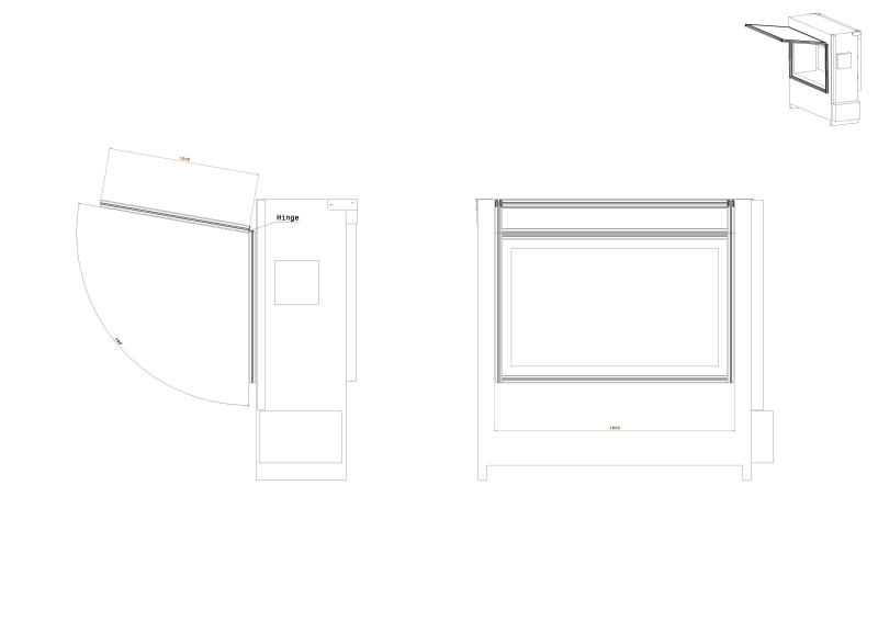

I 'm working with something I've never done before , so I thought to ask if you can help me.
I'll open a window 100 degrees but I have to install the pneumatic air cylinder and I do not know how to proceed .
Where's the best place to assembly the air cylinder ?
How do you calculate ?
All tips and suggestions are welcome.

Simple mechanics problem, knowing the compressed and extended sizes you can figure out where it will fit, then knowing the weight of the window you can check the loads.

I thank you for the time you have taken and answered . I want air cylinder with strip valves and full -package , because of this shall be automatic and programmed with out people sometimes . I have to get the window closed completely by using these air cylinder and frequent so no hot air comes out . Regarding air cylinder you must have the strength to lift and turn , I wonder if it bothered pulling up perfectly vertical ?

To size the cylinder you have to create a free-body diagram with all the connection points in the worst-case position to calculate how the weight of the door translates into force on the cylinder.
You may not know how to do this, but you have to start somewhere. Make a diagram of what you think the cylinder mounting, connections, and stroke might look like, and go from there.
Also, I would plan on two cylinders to prevent warping the door.

Your freebody diagram needs a few items, force to open, force to hold open, how tightly you want to hold it closed, and range of motion. You will need to look at different cylinder positions and mounting methods to achieve the correct motions.
RE: Help with pneumatic?
Basically the connection on the window needs to be level or higher than the other end when the window is closed, but has sufficient extension so that the window will open your 110 degrees. Peak load will probably be at the end as the window reaches maximum cantilever from the hinge, but a couple of quick sketches at 10 degree slices will provide you with that information.
