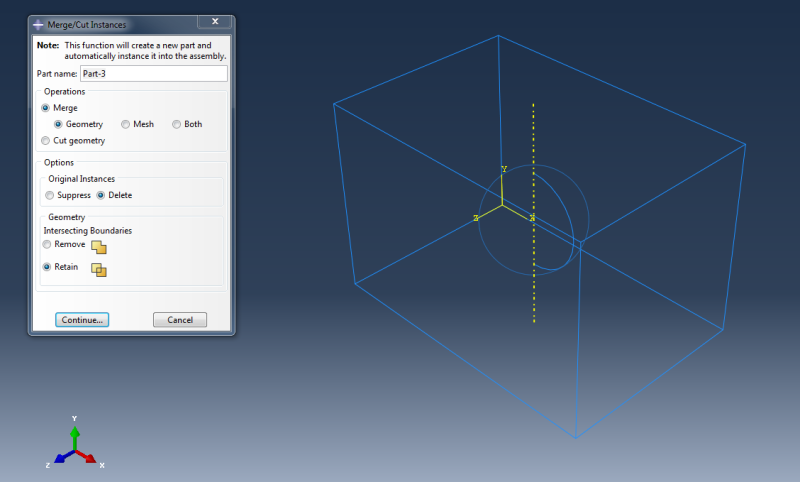

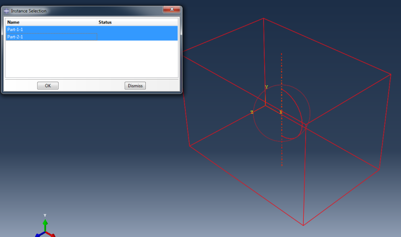

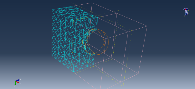

So with the help of Mustaine3 I managed to create a merged solid geometry of a sphere encapsulated in a cube & maintained the inner boundary.
My problem is now that however I mesh it I keep getting a hollow sphere whereas, I am after the spheres surface partitioning the geometry not cutting it. The sphere & the cube are merged, its just that I cant select the spherical region to mesh just the outer region.
I was hoping that I could use this in the same way as a partition but so far no luck.

It looks like you chose "cut" instead of "merge".
RE: Help meshing hollow region
Yeah that's what I thought but when I check the geometry is solid
Both results are solids.
With merge you keep the inner geometry, but you get separate cells for inner and outer regions.
With cut you remove the inner geometry and you have a hollow sphere.

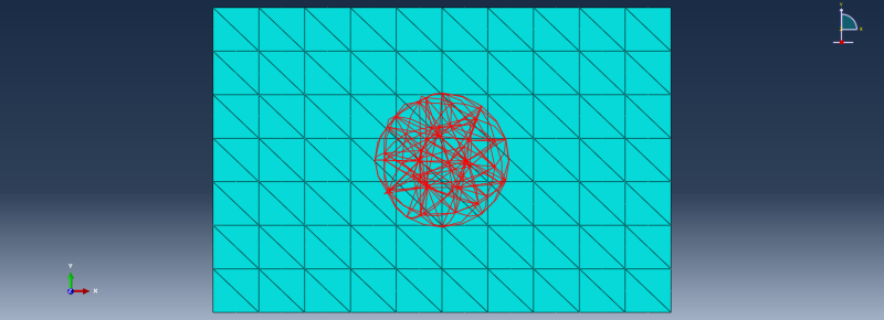

I'd like both regions meshed with a continuous mesh and 2 sets, one with all the elements within the sphere & another with all the elements outside of the sphere.
Your Part-3 is what you want. One part consisting of the two cells. When you mesh that part (or instance) wou'll get elements in each cell with common nodes at the interface. So everything is ok.
You just have to hide one cell and put the displayed elements into a set. Repeat that with the other cell. Then you'll have your two element sets.

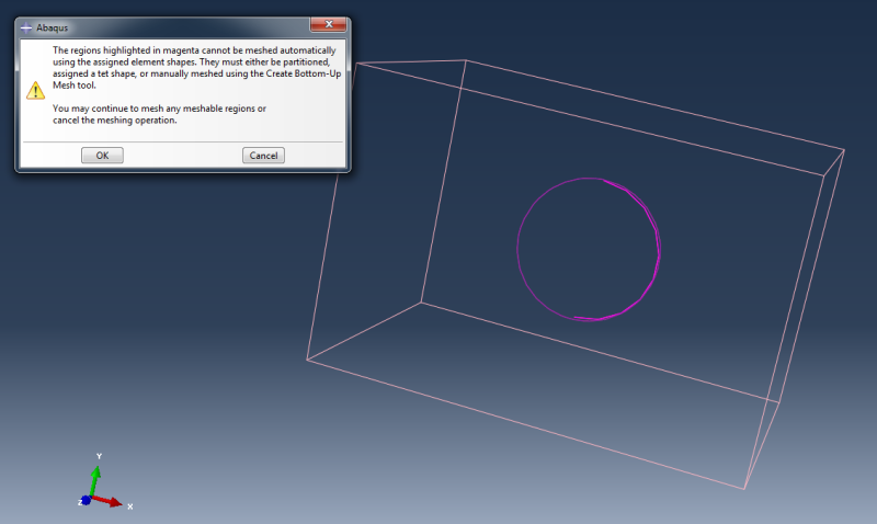

Mustaine3: the problem is that I dont get 2 cells. So whilst the partition is visible in graphics window there is no reference to it in the side plane. Event though I have merged the sphere & the block the mesher doesnt treat the spherical region as a solid, either that or there is no way of selecting that region that I can find.
IceBreakerSours: I have been doing just that, this is why I have opened up the question here. I have tried a number of different approaches, seed part, seed edge, mesh part, mesh region..... but I still get the hollow sphere.

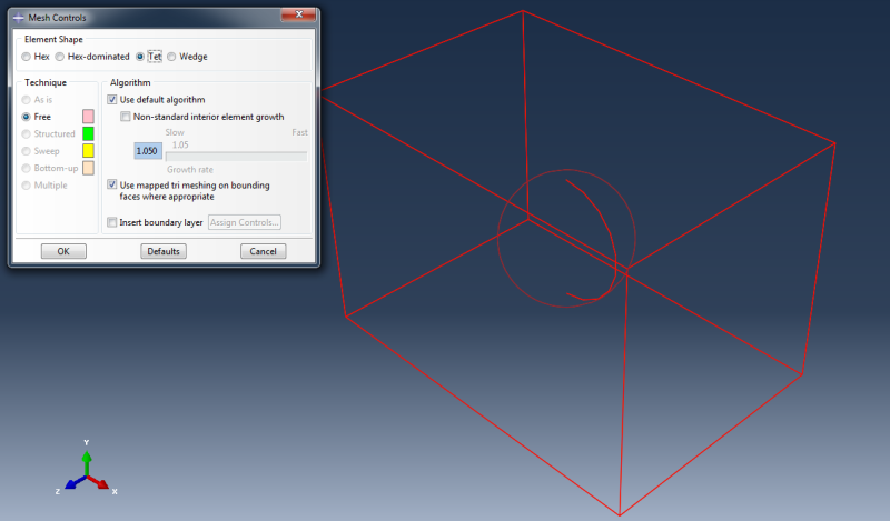

Workflow,
I've tried to partitioning the volume in various ways & tried bottom up meshing but to no avail, I just cant seem to select the spherical region.
eg.
Your mistake is on image 4.
You've just clicked on the outer cell to assign a tet mesh shape. The inner region is unseleted, so it should be a hex mesh, which is not possible for a ball and so not mesh is created.
Assign a tet mesh and select all cells by using a drag box.

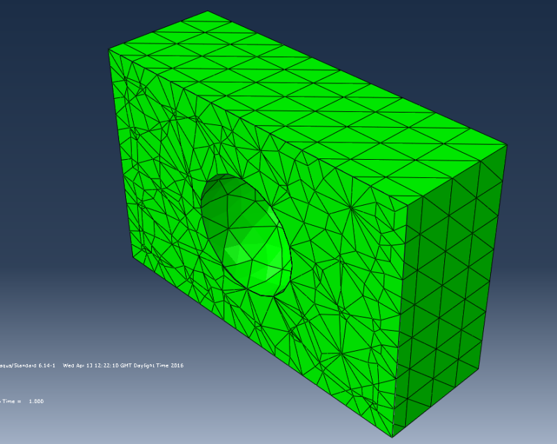

Aaaaaaaaaaah thankyou, so simple in the end, that was driving me nuts.
