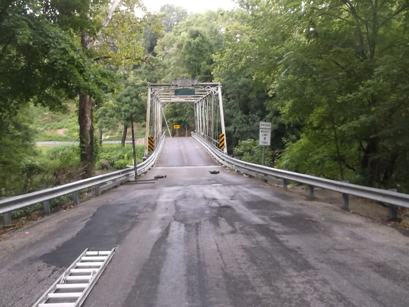

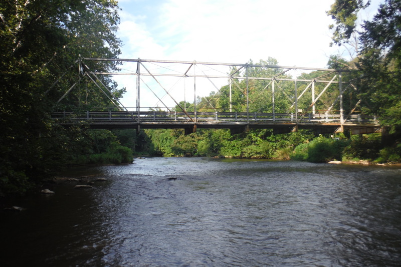

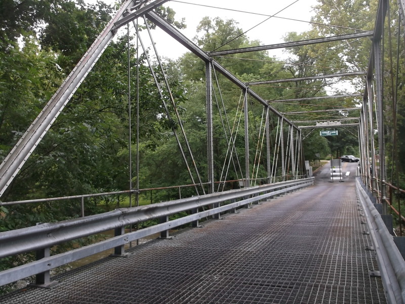

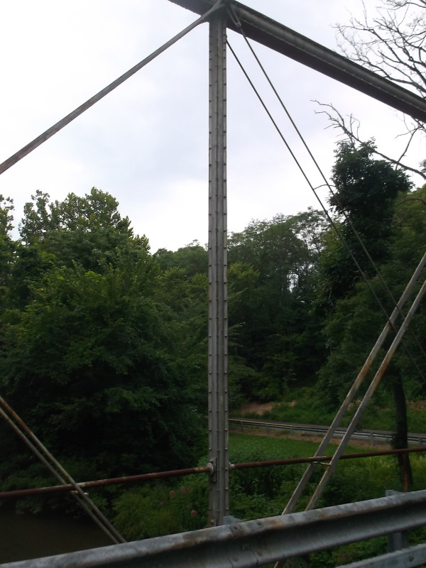

Thanks for the Link Bridgebuster! I didn't think to look at SlideRule's site. This actually helps me out a lot. This one in Pennsylvania and is approximately 131' long c/c brgs.
Here is a few pictures:

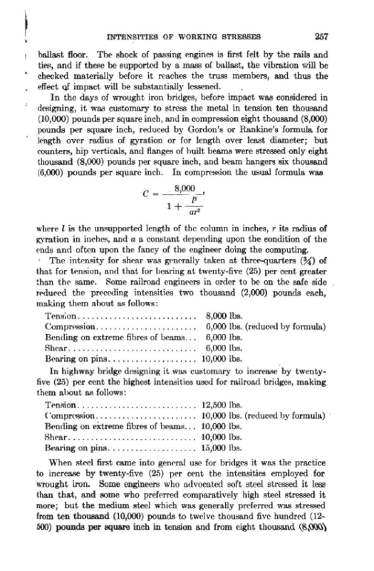

Here's some historical info from J.A.L. Waddell from his book Bridge Engineering (Volume 1, 1916). I came across it while I was looking for information on how our ancestors designed reinforced concrete bridge piers.
