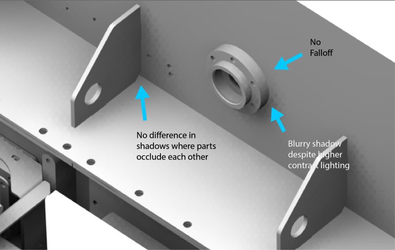

Hi Toost, the "falloff on inside edges" I'm speaking of is a fairly subtle effect, I'm just worried its absence indicates NX has global illumination turned off somehow.

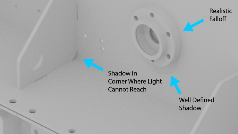

Here are 3 shots illustrating the falloff.
Blender Cycles: Shows a subtle darkening around the base of the flange, as well as a well defined shadow cast by the flange. Also the rib support in the upper left has clear shadows in the 45 degree cutaway section.
NX Ray Traced Studio: The flange seems to be floating in space, and casts only a very blurry shadow. The lighting setup in NX is "Studio II" which should have more contrast than the lighting setup in blender (a light emitting sphere which surrounds the scene), but the shadows are somehow less defined. There is no darkening in the rib support 45 degree cutaway.

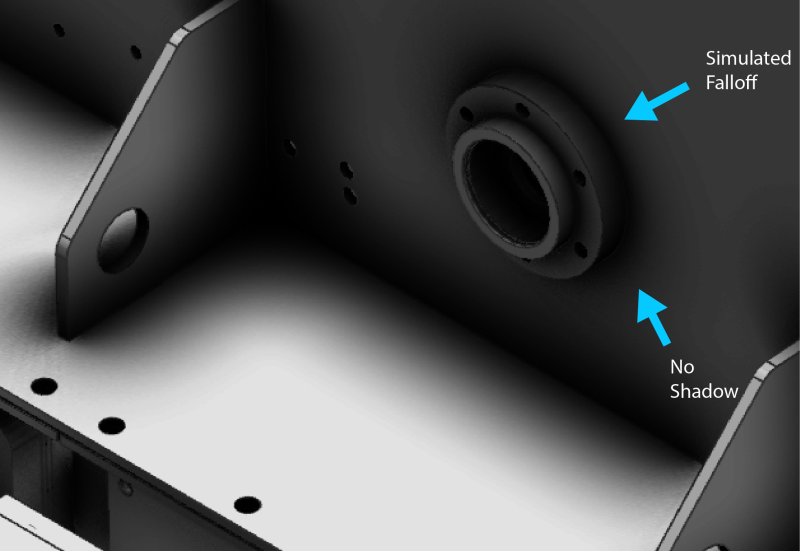

NX Advanced Studio: The inner edges here have a clear falloff created by an ambient occlusion effect, but they are imprecise and not natural looking.
Does that make sense? I've used global illumination in other software (Cinema 4D) and it produces results similar to the 1st Blender Cycles example. Some of the screenshots of NX Ray Traced Studio renders appear to produce similar results to the Blender Cycles render, so I think there must be some setting I don't have enabled.
