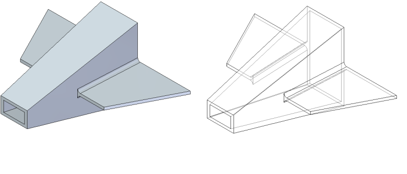

I am particularly interested in converting a machined part with 3d features into a cfrp molded part. For example, a hollow tube with wings:
Can this be done with any process similar to injection molding?

For the most part manufacturing with fiber reinforced plastic FRP is an additive manufacturing process, requiring that the layers of reinforcing be added in the directions that make the finished product most suitable for its intended use. The one thing the material does not like is sharp corners and abrupt changes of direction. Your hollow tube with wings is not a good candidate for this type of construction, although it could be done with a 3 piece mold.
A piece like that is better from die cast metal or 3D printing using laser sintering. Your hyperboloid shape can be made using a drape able fabric that can conform to a 3D shape.

The particular part you have illustrated, a tapered rectangular tube having internal sharp corners, with external wings, would be a bitch to machine from billet in any material, because of the sharp corners. It would be somewhat less difficult to injection mold, though the sharp corners don't help the molded part's performance. As noted, injection molding and similar processes are not super well adapted to use with long fibers as reinforcement, and short fibers, even of a strong material, don't make a particularly strong composite.
Note also that even if you could mold the proposed part with long fibers, you may not be happy with the effect of drilling fastener holes in the completed part, both cosmetic and structural. If you're going to the trouble of molding a part, it makes sense to mold the part to its exact as-used configuration, without secondary operations.
It is my bad on this one, there will be internal radius inside the tube.

I am from the semiconductor equipment industry where the components require high rigidity and experience high acceleration. We are currently looking to convert a small machined parts full of features into carbon fiber parts for weight reduction purpose. It is hard for me to visualize what kind of features on a machined part that cannot be achieved via cfrp. For the resin transfer molding and prepreg material you mentioned, any design guidelines to suit such processes?
Besides that, is it possible to add metal parts/inserts during the layup/molding process (such that the metal part will be bonded to the carbon fiber part)?
