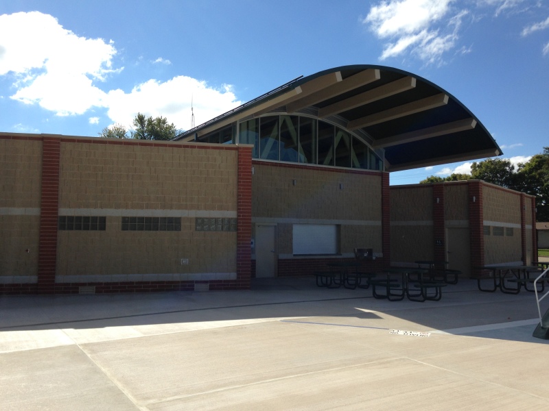

If it is important to you, maybe call and talk with a few more fabricators. The top chords (12x6x3/8) were rolled to a radius of 24'-5" for us on this project.
RE: HSS ROLLED TO A RADIUS
Thanks for the input, after I complete my schematic framing I am thinking it will be a good idea to tabulate a spreadsheet with all the information for my radiused members and coordinate with one or two fabricators.
Thanks for the picture (they really are worth 1,000 words sometimes. This is similar to what I have going on with my canopy (radius members with members cantilevering).
