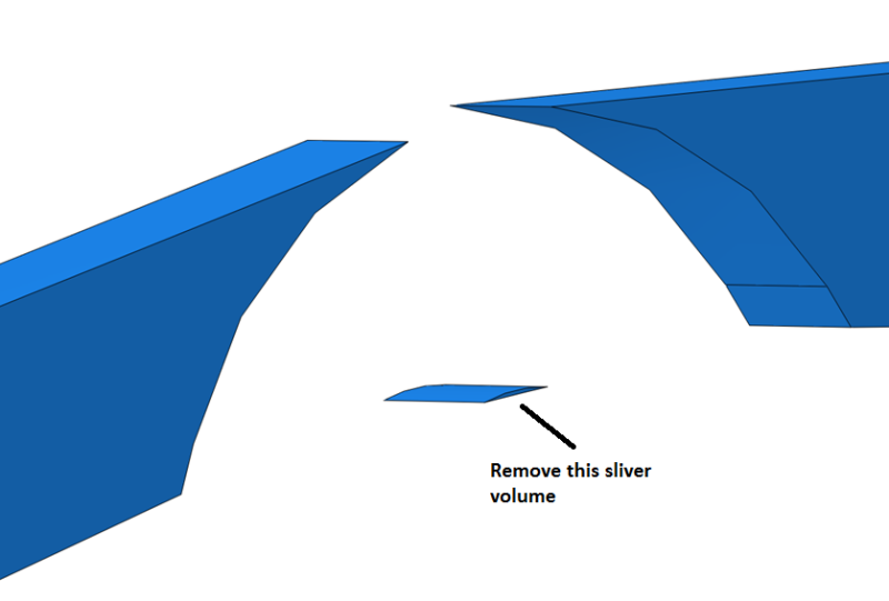

I am trying to write an script to remove cells in a part if the cell volume is smaller than a given value.
Is there a simple command to delete a cell?
This is what I have tried:
def sliverVolumes(modelName, pInterName):
#Class to keep only cells bigger than a certain minimum value 'paramVol': paramVol=volCell/part_volume_r
allCells = pInterName.cells
mask_r = pInter.cells.getMask();
cellobj_sequence_r = pInter.cells.getSequenceFromMask(mask=mask_r);
part_volume_r = pInterName.getVolume(cells=cellobj_sequence_r);
# get faces
for i in range(0, len(allCells)):
volCell = allCells[i].getSize()
paramVol = volCell / part_volume_r
print 'paramVol= '+str(paramVol)
if paramVol < 0.01:
print 'Sliver Volume'
#HOW CAN I DELETE THE CELL HERE???
else:
print 'Not a sliver Volume'
Thanks!

Hi Cooken,
I do not think that the boolean operations are an option, at least when it comes to automation. I simply want to delete small sliver volumes like the one below:
RE: script to remove an entire cell of a part automatically in ABAQUS?
Remove faces? This will automatically delete the affected cells.
Also there is an option in part copy to separate disconnected regions into parts..?

Thanks Cooken, What would be the command for removing all the faces of a particular cell?

If is a separate cell like on the picture, then it is simple. Check all cells and if the cell is too small, ask for the attached faces and then use them in this command form the Geometry Edit option:
p.RemoveFaces(faceList = f[0:6], deleteCells=False)
^ That.
You can perform the action in CAE, then check the .rpy file to retrieve the python command and manipulate into a parameterized/automated script.
