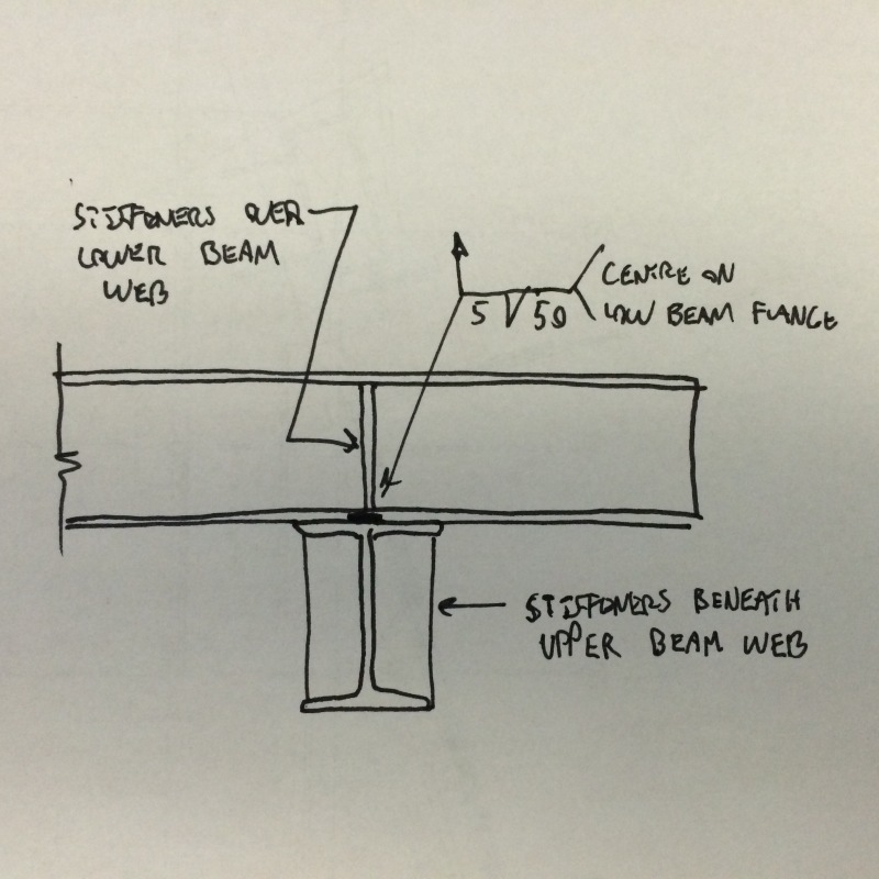

Now the question here is when you have a beam sitting over another beam crossed (assume both are w shapes and same size) and to provide a lateral support for the below beam (which supports above beams sitting on it) by the above beams where do you locate the welds parallel to above beams or parallel to the below beam?
Please draw it so your answer is clear to be understood.

Parallel to above. Parallel to below means welding in the overhead position which is to be avoided whenever possible because it's very difficult to do. I've disregarded your mandatory sketch requirement because time is limited and my advice is simple. If that's a problem, just ignore my advice.
RE: Weld
I'm guessing that this thread is related to this one: Link. If so, nominal 2" fillet welds on the top flange of the low beam ought to be sufficient.

I'd say that something like this is typical. The stiffeners can be omitted or made partial height if one invests the time to justify those decisions.
