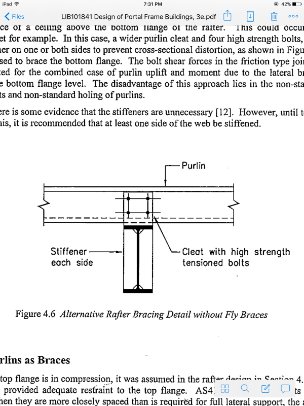

Those frames that you mentioned without fly braces, were they detailed as shown below? If so, the designers of those frames may have used torsional bracing intermittently which is a valid form of LTB bracing.

As for the reference on LTB restraint via stiffeners and rigid purlin connections - I haven't seen that being used in practice although it looks similar to something I have seen in the UK's SCI publications. I assume the designer makes use of the extra torsional stiffness from the stiffener + the tension flange restraint of the purlin connection.

Quote (OP)
Effectively, the web stiffeners and cleat become one continuous plate and, thereby, the purlins are able to restrain bitg the top and bottom flange at each purlin location. I've not seen it done in my market. I pulled the detail from RowingEngineers reference.
