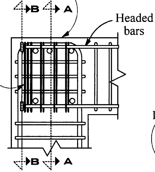

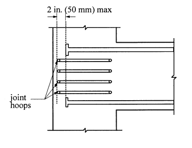

For the concrete free edge what I've seen suggested in ACI 352 and elsewhere is to provide a closed tie or U bar (with legs developed) tight to the head. Similar to supplemental reinforcement allowed by Appendix D. Think that was mainly for ductility and joint integrity (as in a moment frame) though.
It's not that you can't put a head on bars being developed in compression, it's just that you can't count on it. Similar to a standard hook in compression, you'd just need to embed the standard compression development length as if the head/hook wasn't there. If you're not concerned with ductility then would think that even if you did break out the end you'd still have the bond over the compression development length to transfer the force from the bar.
RE: Headed reinforement bars in compression
I suspect that the sketches below are the ACI 352 ones the MrHershey mentioned. I agree that they would add confinement but disagree that they would help with the breakout cone behind the rebar head. None of the bars would actually intercept the breakout cone as would be required for supplemental AppD reinforcing.

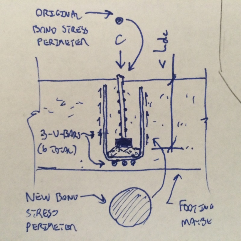

I had been thinking more along the lines of the second sketch except with the bars actually in physical contact (tight) with the heads. And, no, not exactly satisfying Appendix D. Similar in concept to Appendix D except instead of restraining the concrete in the failure cone you're restraining the head itself.
Would need your compression development anyways, would tend to argue that even if you don't work for breakout at the end that you still have that bond from the compression development length to transfer the load. You'd pop the end and then immediately grab hold in bond.
When you first mentioned the ties, I pictured something like what I've shown below. It sounds as though I had the right idea.
Originally, I thought the concept recursive. You start with a big bar that can't be developed in compression, add a headed anchor to compensate, then tie it all back with some smaller bars that need to be developed in tension. All tolled, it would just be the compression development of the whole assembly so you'd be back to square one. I still think that but, having sketched it, my impression is now that it amounts to an effective increase of the bond stress perimeter. My sketch below is a hypothetical case where not enough footing depth was available to compression develop some column bars.
Practically speaking, I wouldn't expect there to be many cases where you'd have enough space to exercise this concept to any real advantage.
