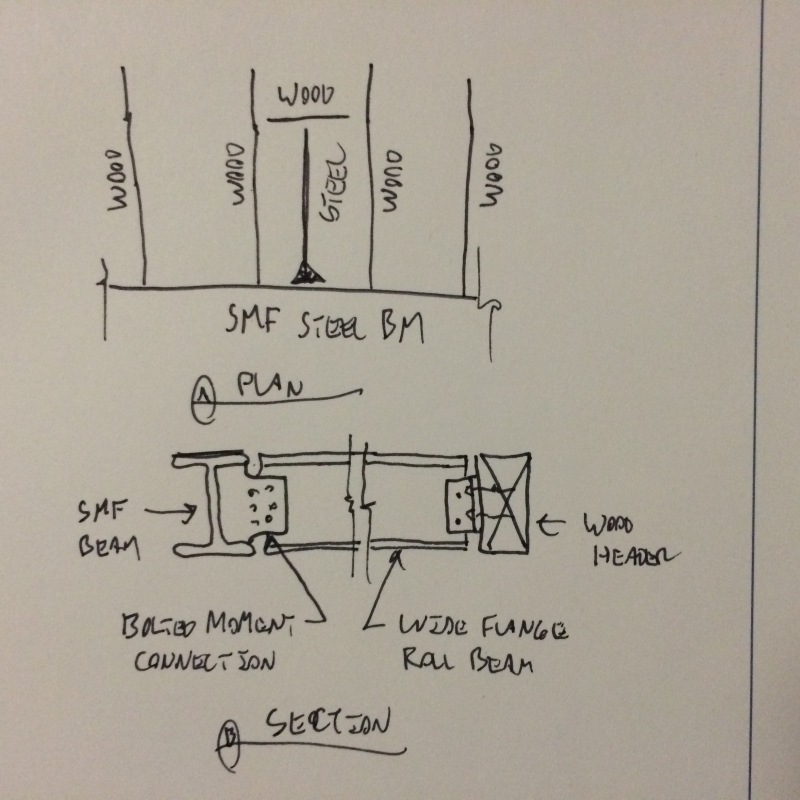

1) I think that you've got to assume plastic beam hinging if you're going to use SMF force deduction values. Otherwise, go with IMF/OMF if code allows based on your SDC etc.
2) A detail that I would support would be a torsional bracing scheme using a short steel section with a bolted moment connection to the SMF beam and headered off to the primary wood framing tying in. This only works where your wood framing is perpendicular to your SMS beam.

KootK,
Thanks for the detail. It makes sense. However, most of our SMF's in the Bay Area are parallel to the floor joists.

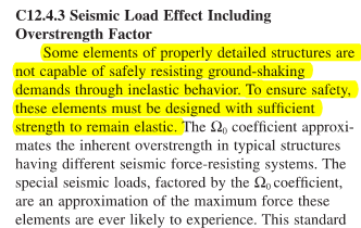

Quote (OP)
If I check the Reduced Beam Section with Overstrength load, and it still remain elastic, then will the plastic hinge really form?
When elements in an RBS SMF building are designed to over strength, they are kept elastic by ensuring that they don't yield before the RBS's go completely plastic. The "overstrength" is the over strength of the SMF system. So, to check the RBS for over strength loading is to essentially say "I'm going to make sure that this beam remains elastic until well after it goes completely plastic!". Hopefully you see the incongruency inherent in that statement.
The only way to claim that the RBS's remain elastic is to design them for R=1.0. And even that's dubious.

Thanks for your input KootK.
C12.4.3 description is the basis of my understanding of the Omega load. However, I know before Omega load was introduced, people used to use R=1 to check for elements that needs to remain elastic. My guess is that the code committee determined that R=1 is too conservative, and very unlikely for a structural element to experience that load level.
