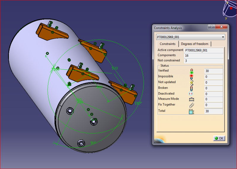

RE: Product Constrains Analysis
Please, have a look at the picture....
How could I find out which components are/are not not fully constrained?
What this picture says?
CAD 2015
If I'm not wrong, the table shows that I have three not constrained components, right?
CAD 2015
Yes that is what the function says...
Also check the Degrees of freedom tab
Eric N.
@CAD2015
Right. And make sure you're in the right product. What are you assembling? Is that a welded fluid container or tank of some sort? What are the units in the screenshot? Inches, millimeters?

The parts that are still in the exploded position are the parts that are not fully constrained.
drewmumaw,
Yes, it is a fluid container. Units: mm.
