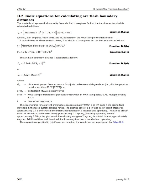

Can we not calculate the bolted fault current using the Lee's method if utility is not providing the total available fault current?
Lee's method requires only the MVA base, %Z and Voltage of the main incoming transformer for the below formula -
Isc = {(MVAbase*10^6)/(1.732*V)}*{100/%Z}
Am I going in the wrong track here?

Look at your supply transformer. %imp voltage or %Z. This is the voltage required to force full load current through a bolted short circuit at the transformer terminals. (At operating temperature. It may be slightly lower with higher current when the transformer is cold.)
Rated current divided by the %Z will give the Available Short Circuit Current when the transformer is fed from an infinite source.
For relatively small transformers on "Stiff" distribution circuits this is often an acceptable figure. It is the maximum current. This maximum value may be reduced by the Available Short Circuit Current of the source.
sajujsam: I am not sure of your convention but the last (*) in your equation may need to be changed to a (/)

Hi Bill (Waross)
Please see the extracted page from CSA code Z462-12. The second equation that I quoted is equation D.2(a)
What I meant by '*' is 'multiply'. I am not sure if I understood you when you say to replace '*' with '/'.

Below is an extracted page from CSA code Z462-12 where they recommend Lee's method for determining arc flash boundary & incident energy. They say that Lee's equation becomes conservative over 600V.

The Lee (1982) equations shown in Table D.1 are for incident energy and not the bolted fault current. Keep in mind that the Lee method is theoretically derived and is very conservative. If you read the appendices of the IEEE 1584 standard, you can see how Lee's incident energy model was derived and under what conditions and assumptions. Generally, the Lee equations would only be used in practice if your system does not fall within the range of the empirically derived equations (shown in section 5.1).

sajujsam; You are correct. I was confused by the bracketing.

Note that nothing is "recommended" but the Annex summarizes the available methods. Also note that Lee's equation is applicable for an open air fault. If you are in an industrial facility, this would not be applicable as your faults would be enclosed arc faults.
