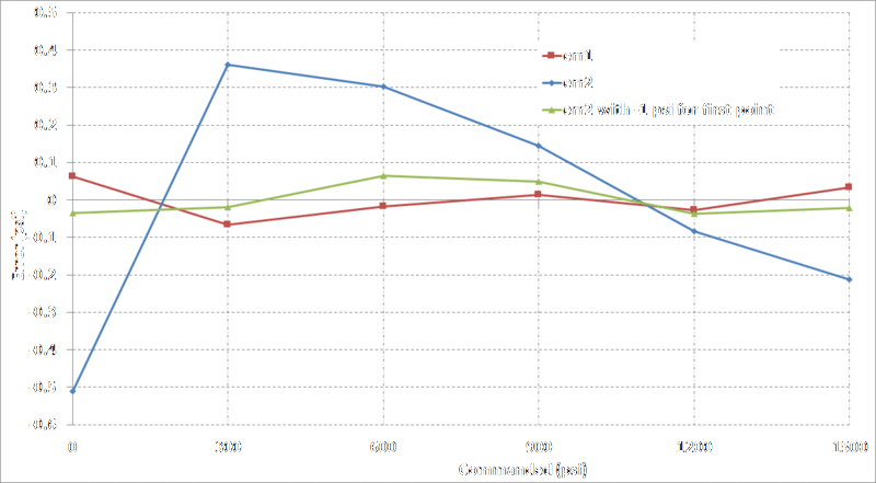

RE: Test Gauge Failure
Perhaps your 3rd party didn't understand the requirements. Did either or both places provide the scale and offset errors?
My quick look suggests that the random error is VERY small. The only anomaly is the 0 psi reading from the 3rd party, which, based on scale and offset, should have been closer to -1 psi, which would still have been well within the requirement.
A true "calibration" would measure the scale and offset errors, which are then applied to the resultant data and the residual error is the uncalibratable error.
Below is a graph, calculations from Mathcad, showing the uncalibratable errors as being quite small, for both cases. You can also see that the second guy's data indicates a scale and offset error in the residual errors, which, if you replace the 0 psi with -1 psi, results in much lower residuals.
Not sure why the text is munged.
