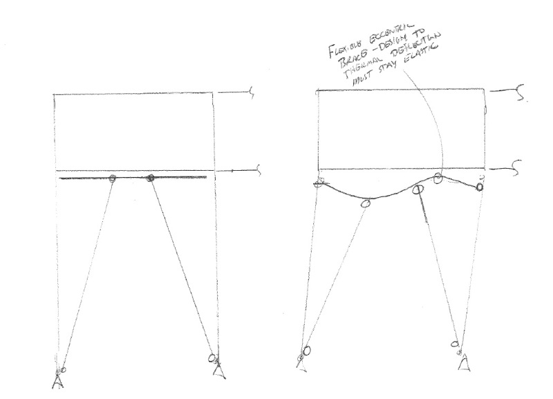

For thermal, we are talking about 1 cycle of loading per year so fatigue won't be an issue. I think the strategy should be to allow for the deflection with a flexible system such as shown in this sketch.
I'm showing an additional framing member since this will give you the ability to size it for just the bracing loads and not need to stiffen it up for any beam action. I'd think that laying a wide flange flat would be a good choice for this eccentric member.
