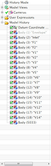

RE: slow .prt file after moving bodies around repetitively using NXopen
Ok, another thing that worth mentioning is that when I added one more body to the "slow .prt file", it was numbered as 5033 (see screenshot). So obviously, 5032 minus 18 bodies were created during the execution, and they seem to occupy some resources even though they were deleted.
