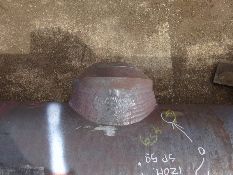

Hi all,
Could this be right (see photo attached)??
Generally speaking, which standard specifies how the weldolet branch connections shall be fitted? I mean when it's set it, set on etc. and what's the proper orientation (meaning which side goes onto run pipe)?
Thanks in advance for all kinds of feedback

O'lets similar to that are typically set-on, don't think I've ever seen that style set-in.
Are there any markings left on the o'let? That's a clue to which end should be set on the run pipe.
RE: Weldolet branch connection looks so strange... (photo)
That does look to me like a butt weld-o-let. However, its bevel has not been fully filled out with weld, which is required to develop the full pressure rating of the component as a self-reinforcing branch. If the full rating of the branch is not required (often the case, since the typical butt weld-o-let is 3000#), you will have to determine if the quantity of weld deposited is suitable for the service.
No idea why the welding looks so terrible- there's no scale to indicate how big this thing is...
It is possible that the o-let was set on with an excessive root gap between the end of the bevel of the o-let and the OD of the pipe. No idea why that would have been done.
The WOL in the picture can only be installed as a "set on" type of fit up. The part of the fitting that goes on the header is contoured to fit the contour of the pipe it's being installed on. Root opening tolerances are in welding procedure specifications. In all my years in the welding industry, I have never seen this type of fitting used with a "set in" type of fit up.

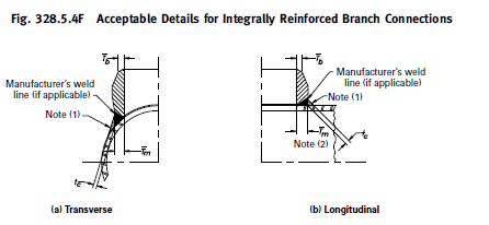

The current B31.3 edition, 2014, holds a pi ture on how to install/fit a weldolet.
Fig 328.5.4F no less. Learnt something today.

Weldolets and their Chinese clones are configured to match-up with a certain size of pipe ......one weldolet size does not work everywhere.
Compare the configuration of a 2" set-on weldolet configuration for a 4" NPS pipe versus one for a 20" pipe.
The weldolet in the picture is not the right size for the run pipe ...
Plus, the welder is an idiot ....

Cut it off, refit and reweld it.
Before it becomes a projectile attached to one end of a pipe.

Looking at this again, whilst there might be a manufacturers weld line hidden below the top line of the weld, the concave nature of the weld is not permitted. This should be straight down as per the drawing in B 31.3. Otherwise you don't have enough metal for the area replacement design.
I don't think we've ever understood the branch and header sizes involved here, the wall thickness, the pressures, the contents or the design code (b31.3?) Also what is the branch? Does it have high vibration or stresses?
It still think that in the diagram below you are in the incomplete welding. Then compare your picture with the completed on below - compare and contrast.... If you saw an incomplete butt weld as shown on the diagram would you just let it go as well??

Unless there is something wrong with my eyes both photos show the fitting installed the same way - the first shows the weld is incomplete and the second shows the weld completed ?

Gator, well spotted - they didn't turn it. Simply completed the welding. And to be honest, we are confused with this "orientation" thing. In the first image it seems that the weldolet should be flipped but now, when they filled up and completed the weld it looks allright...

The final photo does not appear to have a radius at the weld to main juncture as is indicated in the sketch posted by Littleinch. So there is still a stress raiser at this junction. Hopefully there is no significant cyclic loading. Once seen a 6"nb weldolet on a 12"nb line completely snapped off due to a combination of circumstances, all because of a stress raiser.
Denstan, thanks. I agree, it is not the smoothest transition but this isn't for cyclic loads so should be fine. And it is much better that what was there before.
