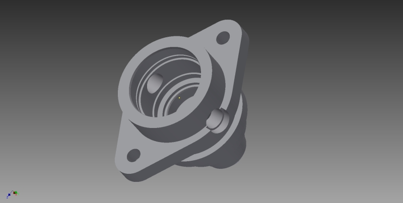

can a feature's position tolerance having itself as a datum?
i like to control the hole location real tight ref to main axis and end plane, but it could be loose relative to flange orientation.
if the part axis A, end surface B, the hole in concern C, the position tol of the hole "POS dia .002 S A B C".
or i must generate the line connecting two flange holes as D, then specify "POS dia .002 S A B D"?
thanks.

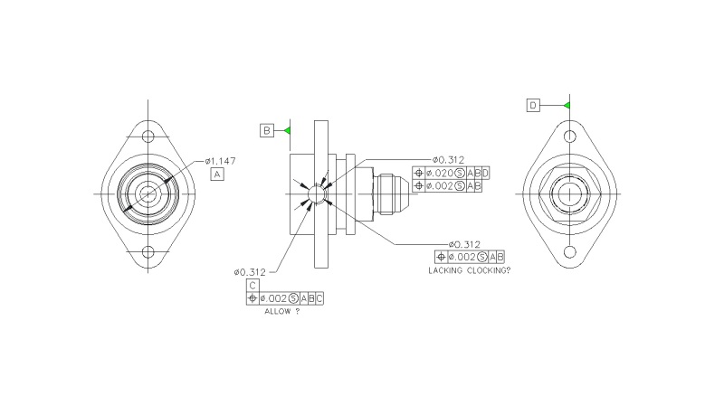

That makes no sense. If a feature is tagged as datum A, its location to datum A is perfect, by definition. Also, please do not say "axis". You cannot apply a datum to an axis.
You can specify datum A as the end face, and datum&bnsp;B as your critical diameter. On that diameter, a positional tolerance will have no meaning, but perpendicularity to A is perfectly reasonable. I would not call up a diameter as a primary datum unless it was long enough to accurately define an axis. By specifying a face and diameter in that order, you specify a face for perpendicularity, and a locating feature.

Question to dho: Exactly which of the holes shown on the picture is your hole C? Which features are datum features A and B?
Question to drawoh: Can we really specify the end face and the critical diameter (whatever it is in this case) as datums A and B respectively, or rather as datum features A and B?
RE: position tolerance
Are we really sure it is functioning like shown, or maybe the face parallel with the shown datum feature B should be the primary datum feature?
Then A should be secondary and everything else should be positioned / profiled to B primary and A secondary.
No need for clocking. And the simultaneous requirement will take care of the clocking.
If the part is measured on the CMM and the clocking is needed, then the inspector is free to pick any of the flange holes, but will make the inspection more stringent than the designer wants/allow, in other words will reject some good parts due to an artificial alignment imposed by the CMM and not by the function.

i still would like to ask. would anyone specify the GEO tol for this part properly. so, it has a tight control on the .312 hole intersecting the main bore at 90 degrees and away from the end surface XX distance, but could be off some relative to flange orientation?
See 7-41 from 2009. Use same concept, but add flange/holes location to the same DRF.

so, my 3/31/16, 19:46 thread, geo tol in red "circle" would be acceptable.
thanks.
Drop D as tertiary from upper segment.
Drop the second segment
Add 2x pos. req. for the flange holes to A primary and B secondary.
Add profile req. for the flange shape/size to A primary and B secondary.

When we ask about part function, what we mean is how does this part interface with the rest of it's related components. I see a flange with holes in it. This highly suggests that the flange bolts against something. If this is true then the flange face would probably serve as a better---and more functional--primary datum feature.
I just can't help but bring back up your notion that proper GD&T has nothing to do with function. It has everything to do with function, that's why we're asking questions before just throwing out random suggestions. This part can be properly toleranced in a variety of different ways but the one that communicates function is the one to use.
