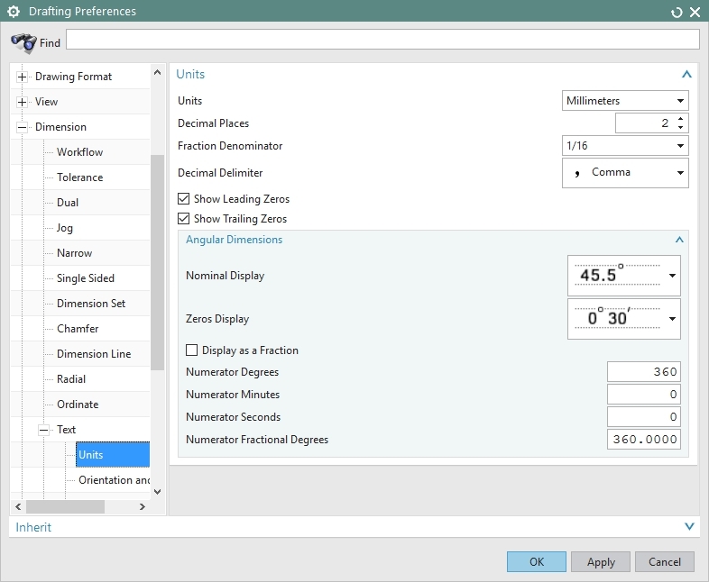

I don't see any regional settings that stick. So far I just edit settings individually, OR just inherit each dimension. How can I make two decimal places after the . for example standard for each new dimension? Thanks!! NX 10
RE: Can someone tell me how to set the decimal places settings in drafting so they apply to all?
File -> Preferences -> Drafting. Select Dimension -> Text -> Units and set Decimal Places to 2 and OK.

This you can find in the Customer Defaults...
Drafting - Annotation - Dimensions
