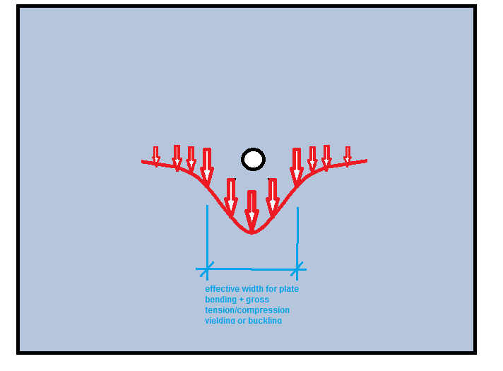

Please see attached drawing.
I am going to use a M12 eye bolt DIN 580. And the force is applied parallel to the base plate. You can find specifications on the eye bolts here:
DIN 580 Eye bolt spec
The WLL for the eye bolt is 1700 N, and normally the breaking strength is 5 times higher eg. 8500 N. How thick should the plate be to support the eye bolt? I expect the force to be applied 30 mm above the plate surface. I suspect that the moment applied to the plate is the critical factor.

Best solved by FEA, but there are approximations for moments on plates in Rourk's formulas. Shear at the influence perimeter might control for tear out; however, you can get a lot of distortion before that occurs.

Be very careful! There is a lot going on here for a non-structural person. I hope this does not involve human life-safety - if so, you should have a structural/mechanical engineer help you out. One tough thing for your calc is determining the effective width of the plate (transverse to load direction) that can be used to resist the load. The effective width is a function of poisson's ratio and also the thickness of the plate. In gusset plates, the "Whitmore Section" is a common way to limit the effective width to extents of the peak stress distribution.
http://www.eng-tips.com/viewthread.cfm?qid=108516
http://msc.aisc.org/globalassets/modern-steel/stee...
Search for "whitmore" in the forums for more posts.
If the plate span is long, you will need to consider buckling from the compression component of the load. Regardless, you need to consider combined bending and axial stresses (P/A + M/Z) over that effective width. Further, bolt bearing will need to be considered. It looks like edge distance is not an issue??
