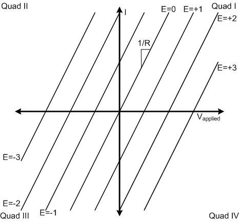

RE: Regeneration space theory in 4-quadrant regions of operation of DC motor
Like Skogs, I found the plot you showed more confusing than explanatory. I decided to create a plot that shows the principle in the more traditional, and I believe clearer, format.
The key difference is that the horizontal axis is the (signed) voltage applied by the drive, not the motor back EMF. The vertical axis is still the resulting (signed) current.
The diagonal lines are constant (signed) back EMF values. (Don't worry about the units - it's the concept that's important.) So go left or right to get to the applied voltage, then go up or down to get to the back EMF, and you get the resulting current, and you see what quadrant it's in.
At root, all this plot is showing is the equation
I = (V - E ) / R
where V is the applied voltage, E is the back EMF, and R is the resistance. (We are ignoring the transient L*di/dt term here.)
Quadrants I and III are motoring; quadrants II and IV are generating.
I hope this is a lot clearer. You should still take Skogs' advice and study some good references for a deeper understanding.
Many thanks cswilson for the nice chart. I have a question: wg=hat does it mean physically that back EMF and applied voltage are opposite. You said in your first reply that "If the applied voltage is of the same sign as the back EMF voltage and of lesser magnitude, or of the opposite sign, you are generating, converting mechanical power to electrical power.".
Thanks in advance
In normal operation, the difference between the applied voltage and the back EMF is small.
The effective armature voltage is the difference between the applied voltage and the back EMF.
This is so important that it bears repeating.

Let's look at the two armature terminals, which we'll call U and V. With an active rotor magnetic field of a given polarity, applying a voltage across the terminals will generate current and torque.
Let's say the voltage on U is greater than the voltage on V, and we call this a positive applied voltage. With no load torque, this causes the motor to spin in a direction we will call clockwise.
If the voltage on V is greater than the voltage on U (negative applied voltage), this causes the motor to spin counter-clockwise.
Next, with the armature terminals open circuit but measuring across them with a voltmeter, and with the same rotor magnetic field, spin the motor up mechanically clockwise. You will see the voltage on U greater than the voltage on V. This is the back EMF voltage of the motor, positive in this case.
If you spin the motor mechanically counter-clockwise, you will see the voltage on V greater than the voltage on U -- a negative back EMF.
Now, look at an instant when the motor is spinning clockwise. It does not matter what caused it to spin this direction: applied external torque, applied current, or some combination. It will have a "positive" back EMF as we have defined it here. We use our drive to apply a higher voltage to terminal V than terminal U -- a "negative" applied voltage.
Consider a specific example. The motor is spinning clockwise at a speed that produces a +20V back EMF. We apply a -10V voltage across the terminals with our drive. This creates a current I = (V - E) / R = (-10 - 20) / 5 = -6 amps for a 5-ohm armature resistance.
This is significantly different from the case where we apply a +10V across the terminals. There we would get I = (10 - 20) / 5 = -2 amps.
Of course, you must understand waross' point that the currents create torques that change the speed and therefore the back EMF, so the solutions are constantly changing -- you really need differential equations to understand the behavior over time. But this is a start.

Many thanks waross and cswilson.
@cswilson
Just to clarify,
In the first case I = (V - E) / R = (-10 - 20) / 5 = -6 amps, E>V and opposite signs and the electrical power will be positive(V*I) while in the second case I = (10 - 20) / 5 = -2 amps, E>V and same sign, but electrical power is negative (V*I). I understand that both case 1 and 2 are in braking mode as E>V, but one has negative power and other positive power. Could I consider the regeneration happens only with the negative electrical power case.
No, that is absolutely not the case! (But it is a very common misconception.)
Consider the motor as a "black box" and just look at what happens electrically at the terminals. If V and I are of the same sign, you are transferring electrical power into the motor, converting electrical power into mechanical power. This is called "motoring".
If V and I are of opposite signs you are transferring electrical power out of the motor, converting mechanical power into electrical power. This is called "generating".
To confirm, consider the mechanical system. If the applied torque and velocity are of opposite signs, the motor is being decelerated by the electrical system. The motor is losing kinetic energy, and that energy must go into the electrical system. This is called "generating", and it occurs regardless of whether E and V are of the same, or different, signs.
If you read Skogs' initial reply above, the attempt in the diagram you showed to make a distinction between the two cases you cite is one of the key things he did not like about the diagram.

Another way to view this is be looking at the armature current. In the real world the brush-gear is somewhat non-linear so for the sake of simplicity we will neglect the voltage drop across the brushes for now.
The simplified armature current will be determined by the DIFFERENCE between the applied voltage and the back EMF.
Consider a motor driven at a speed such that the back EMF equals the applied voltage. If the motor is allowed to slow down, the back EMF will decrease and the difference in voltages will cause a current to flow. The slower the motor, the greater the current and the greater the torque trying to accelerate the motor.
If the motor is driven over-speed, the back EMF will exceed the applied voltage and the machine will be generating, or regenerating if you prefer.
The difference between the applied voltage and the back EMF determines the armature current.
The armature current, and the relative directions of the current and applied voltage determines the quadrant of operation.
The difference between the applied voltage and the back EMF is relatively small for all normal modes of operation. (Save for starting. The same relationship holds but the voltage differences and the current may be many times normal during starting.)
The difference in speed between full current motoring and full current regeneration is relatively small.
There is a relationship between voltage difference and the speed range between motoring and re-generating.
Work on an understanding of how the difference between back EMF and applied voltage affects motor action or re-generation, at all speeds and in both directions..
Then try to express those relationships in a four quadrant graph.
