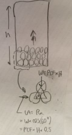

I first thought about using the equivalent weight as compare to water, assuming douglas fir and a specific gravity of 0.50. This seams conservative though because there are an abundant amount of internal frictional forces at work here. The total weight of wood that this can hold is around 120,000 lb. This equates to about 20pcf of material inside. Would that be a reasonable volumetric weight to assume? It seams big though when calculating the pressure at the bottom of the box...600 psf.

If I assume 35 off and then apply 50% of that for horizontal pressures seams reasonable.

Assuming super smooth cylindrical logs stacked as non-randomly as possible, I get lateral at 50% vertical as well. I would assume that a full bin considered statically would dwarf the impact of small groups of logs getting tossed in dynamically.

Crap. I think that my own model above might actually predict 0.25 x H x PCF.

If the firewood dropped from a conveyor it will not be neatly arranged as per KootK sketch?
If the firewood is also pre split then it could be all manner of shapes?

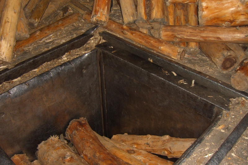

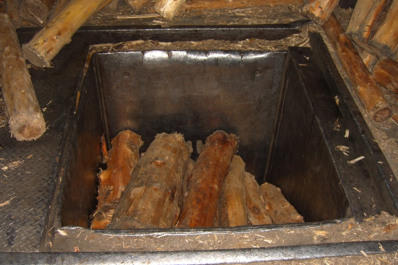

Having done some engineering for a groundwood pulp mill and seen them load large logs into hoppers exactly as you described the steel was polished smooth from the logs and beat to hell and back. Make the walls of this robust as the impact of logs is going to be quite large.
Professional and Structural Engineer (ME, NH)

Thanks for the pictures!
We were initially going with 1/4" steel plate on the inside, and that would be supported by 6" vertical steel channel on the outside at 24" o.c. We currently have it designed to look kind of like (3) storage containers stacked on top of each other. I think we may explore tightening up the spacing of the vertical channel. I will post a pdf today sometime of what we are looking at doing.

agree with TME...the sides may start out smooth,but as stated, will get dented from random concentrated loads...so I would also make the pl a min of 3/8" to try and address this...changing external stiffener spacing would not directly prevent this denting....

Going off of memory I believe the plate for the pulp mill hoppers was 1/2" thick or so. This worked well but there were still places where the logs had dented or punched through the plate. Overall they were durable enough and actually the concrete floor was the reason we were there.
I'd say SAIL has a good idea, somewhere around 3/8" to 1/2" would be my rough guess of the thickness you'll want to target.
