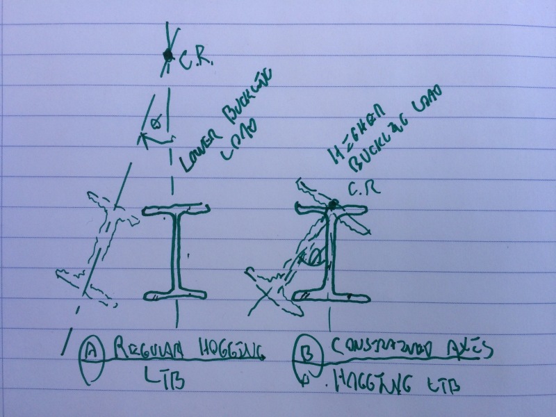

I am using staad pro to evaluate a moment frame system. I am using the steel code check and I am getting an overstressed ratio on my frame beams that I know is not correct. Since the beam is see a negative bending moment it is taking the beams capacity as fully unbraced.
Is there a way in staad to have the program consider the bending inflection point to be braced? Or should I just look at the bending diagram and manually but in the UNB value.

The inflection point is never a braced point. Considering it such is incorrect. In staad you can (and should) be specifying the unbraced length for each member if it's braced at more or less than the node to node distance.

There is also something more demonstable however. That's the difference between regular, code LTB and constrained axis LTB. Constrained axis LTB numbers can be significantly better. If you have rotational bracing at the columns and any splices, and you run a constrained axis LTB check, it should be pretty rare that your capacity would come out less than the values calculated assuming IP as LTB braces.
The main problem with the constrained axis check is that it's not usually built into software and hand calcing it is a fee killer. Josh should really take care of that for us.
