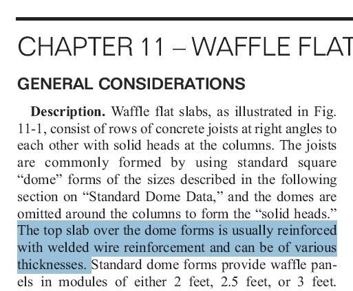

My 1963 CRSI Handbook says to use 6"x6" 6/6 welded steel wire mesh in the 2½" slab of waffle slab systems. I don't have the latest CRSI Handbook here at home. Does the CRSI Handbook still say that?

Quote (ajk1)
It does. See the snippets below taken from the 2008 10th edition.

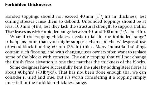

One of my British references has the blurb below to say about "forbidden" topping thicknesses and curling. That said, I've done a lot of 50 mm toppings successfully over precast, albeit with wire mesh.

10th edition, 2008.

I stand by both of my original points but consider them to be relatively inconsequential. As I mentioned, I've 50 mm topped plenty of precast with the mesh probably at the bottom of the topping. And, to my knowledge, nothing has gone awry.
