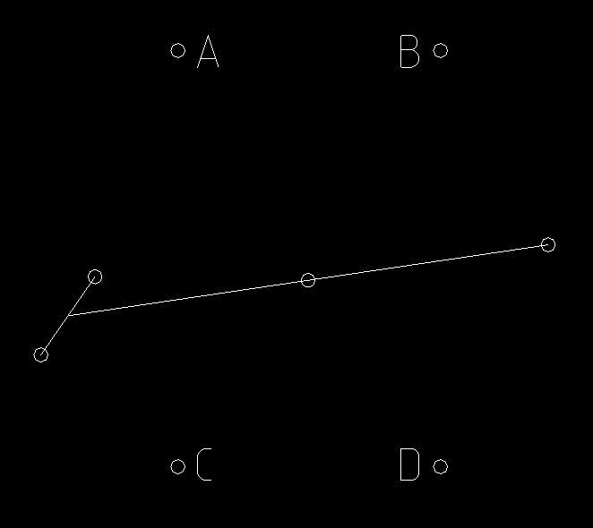

Hi all!
Apologies if this is in the wrong spot as I am new here.
This also may seem pretty basic problem, but there is some argument about it going on in my office so I wanted to see what others thought.
Below are two scenarios.
Basically just looking for the reactions at A, B, C and D
All loads shown are acting into the page.
The reaction points are rollers that can roll towards the AB end or the CD end
Look forward to you help
any tips pointers about the problems or the forum please let me know
Mat

Structure would look something like this

The single load of 49kN is at the centroid of the three other load points
So for the single load.
Taking moments around an axis BD
AC=(49*186)/369 = 24.699kN
Taking moments around an axis AC
BD=(49*183)/369 = 24.301kN
A=AC*(262.5/586) = 11.064kN
B=BD*(262.5/586) = 10.886kN
C=AC*(323.5/586) = 13.635kN
D=BD*(323.5/586) = 13.415kN
Sum of Reactions = 49kN

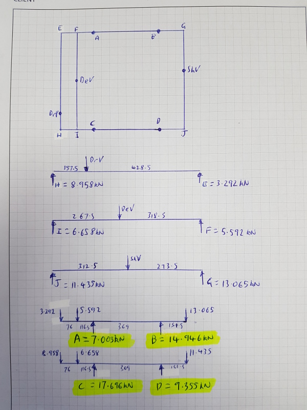

having a "grillage" of beams, each statically determinate, greatly simplifies the problem.
RE: Point Reactions
Do you mean like this?
RE: Point Reactions

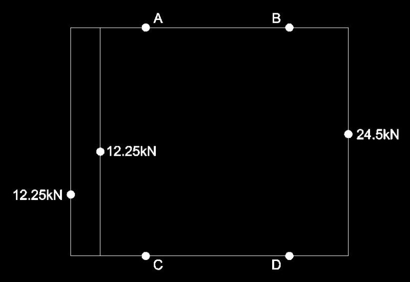

So the load at the centroid position is attached to the individual load points via a steel wire rope.
Obviously this brings horizontal loads into the formula but for simplicity at this stage I was just working on the verticals as the horizontals should all cancel out.
So I guess my question is.. which is the best way to determine the correct reactions?

The structure is as per this diagram
The load at the centroid in the attached to the individual load points via a wire rope
As I said.. It has been simplified at this stage to remove an horizontal loads, and just concentrate on the verticals.
So 49kN at the centroid
will equal 24.5kN on each side
so the two loads on the left hand side will both equally see 12.25kN
and the load on the right will see the 24.5kN load.
apologies if I am not being too clear...

So if I treat it as 5 beams then I get this scenario
A = 7.66kN
B = 14.29kN
C = 17.04kN
D = 10.01kN
Much the same as my calcs above..

RE: Point Reactions
A "rigid black box" is indeterminate when there are four supports. The solution requires a knowledge of stiffness of the box. The black box structure is determinate with only three supports. You can say, however that the centroid of the applied forces and the centroid of the reactions are identical.
The simple span beam structure is determinate and all four supports are required for stability.

What does that mean? The problem is indeterminate, so the calculation is invalid. It cannot be solved by statics alone.
Consider the 49kN load located as shown. Take moments about AD. The eccentricity of load from diagonal AD is about 16 mm toward C, practically on diagonal AD. If support B is removed, support A takes 262.5/586 * 49 = 21.95 kN and supports C and D together take 27.05 kN with C taking only 2.51 kN and D carrying 24.54 kN.
Alternatively, consider moments about diagonal BC and nearly all of the load is carried by supports B and C.
The correct analysis must take into account the stiffness of the box.

The beams are statically determinate. No matter how stiff they are, the answer is the same. If the supports are not precisely at the same elevation, the answer is the same.
The infinitely stiff plate is statically indeterminate to the first degree because there is one redundant reaction. If one of the supports is a hair's width higher or lower than the other three, the load is carried by three supports.
We have all sat at a wobbly table in a restaurant where one leg is shorter than the others. Lean on it one way and the short leg takes load. Lean on it another way and the diagonally opposite leg takes load. If leg A is shorter than the rest and the load is centered, the entire load is carried by B and C.
In the real world, we do not have infinitely stiff members and we do not have supports which are built precisely at the same elevation and even if they were, we cannot be certain there will not be differential settlement.
From statics, A+B, C+D, A+C, B+D, B+C and A+D can be determined but individual values for A, B, C and D cannot be determined without considering compatible deformations of the black box and the four supports.
